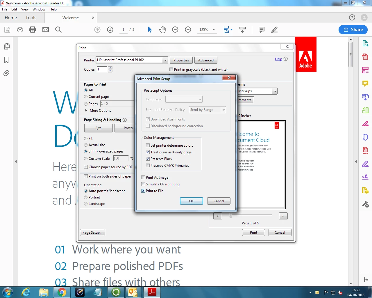

    Hi, not sure if this helps, I have had issue printing on reader since update.  only part of page is printing rest is blank.
    If i when I print I remove a tick if ticked from print in grey scale and then on the advanced tab tick print as image I can print.
