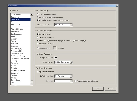

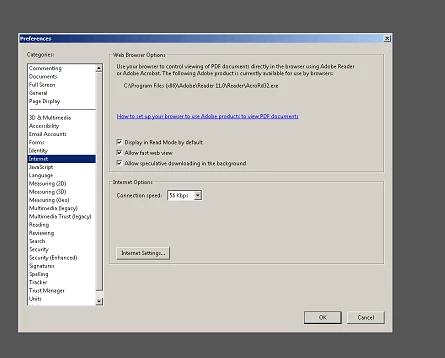

Included brief snapshot of configuration. Require assistance to troubleshoot this error
