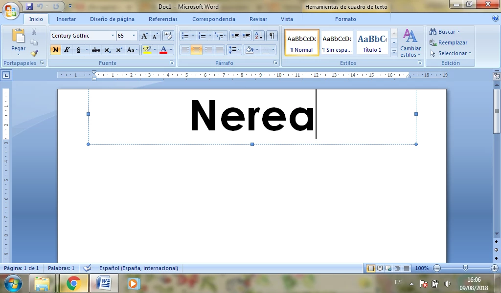

Yes, I will try to explain the steps also leaving photos of the steps so you can see them clear:
1) I open Word, create the file with formats, texts and colours:
This is the Word I use:

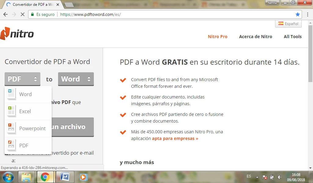

-I do not know how to change the file from one program to another so I search and use this website:
- I choose the file, click my email, and receive the file from word to pdf format. But I receive a pdf blank sheet.

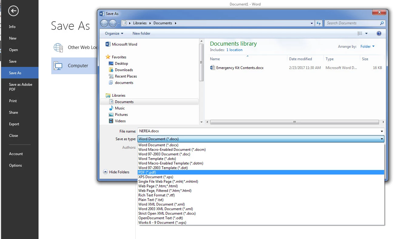

Ah. Ok. You are using an online pdf converter. Nitro pdf. They are known for having problems. You don't need it though since Word has the PDF function built in.
With the Word doc open go to Save as, name the file then under the "Save as type:" choose "PDF"

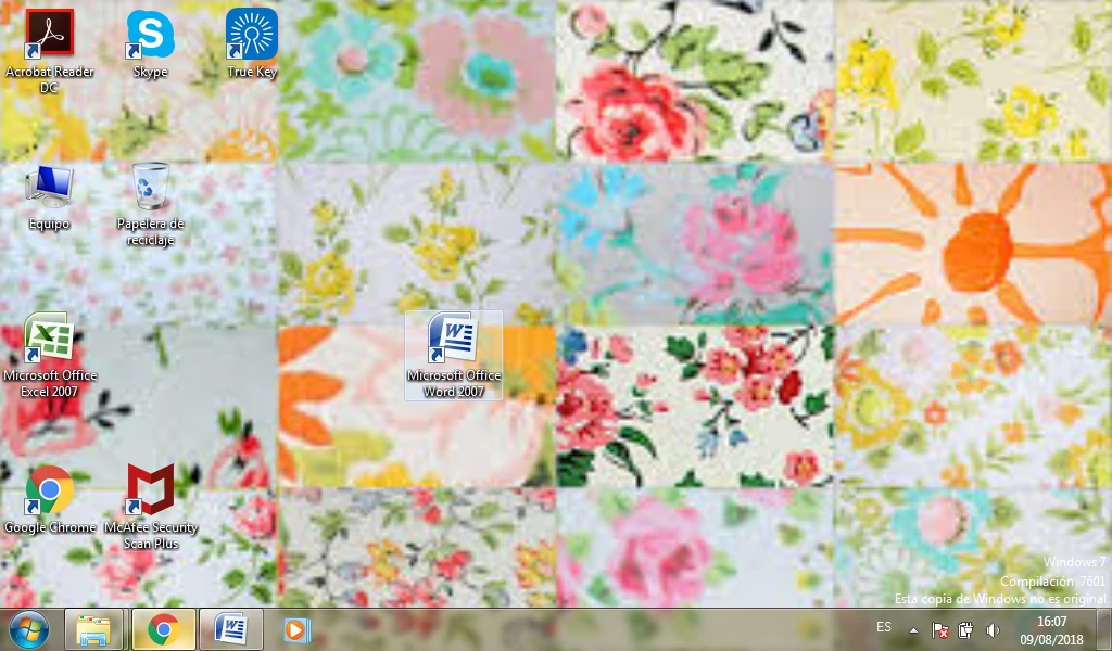

Hi John,
I do not know which Adobe Programm have. My uncle installed and kee it up to date for me since I generally do not understand about software. Assume is not paid though. Could that be the reason for what the word doc does not save in pdf format? Excuse my low level of the lenguage.
