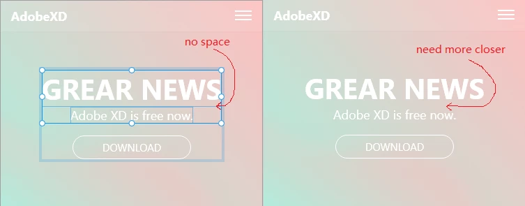

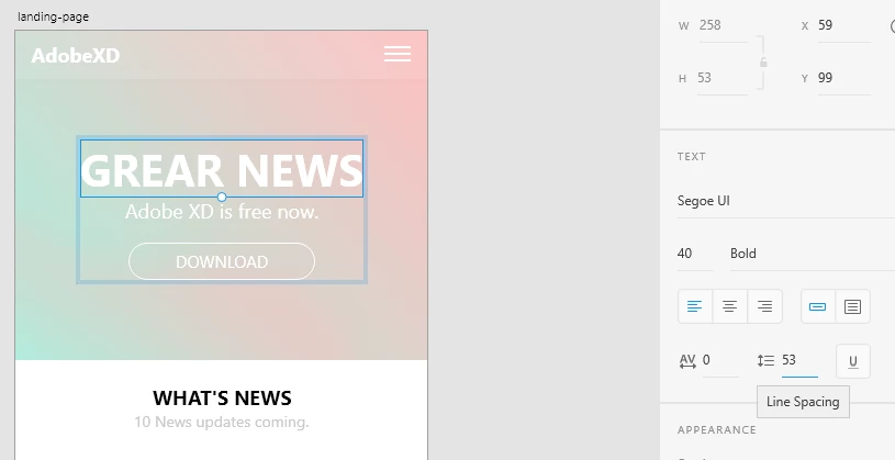

Question 1: I can't see any difference no matter what line-spacing value I entered.
I need two fonts more closer,but because of the line-spacing, there is no space. What should I do?

I think I found the reason.
Two lines type need move one more pixel closer, though there is 0 distance between them, then you can get the same result as browser.
That't strange, don't know why it is.

I tried testing your first question but was unable to reproduce it.
Can you try doing the following?
- Type GREAT NEWS
- Press the Enter key
- In the next line type Adobe XD is free now
- Select both lines and try reducing the line spacing.

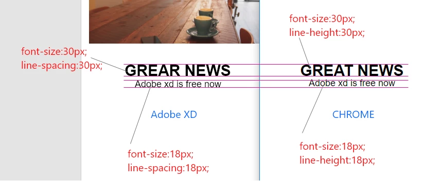

Can you see the difference between CHROME and AdobeXD?
They use the same font-size and line-height, but get different results. It confused me.
