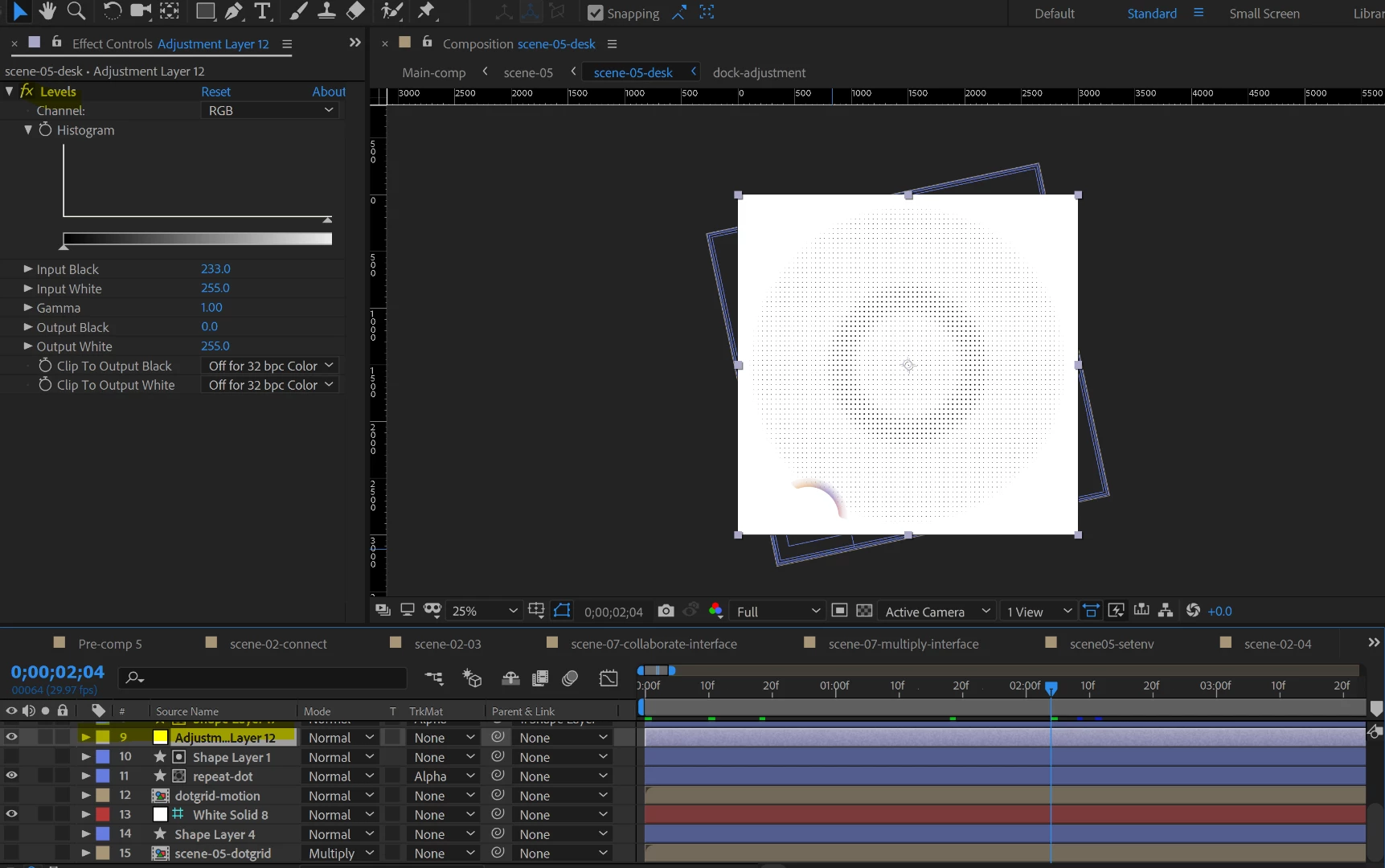

adjustment layer effect gone when I use that composition in other compositions
  • November 17, 2018
  • 1291 views
I made a composition to apply adjustment layer with level effect, and when I use that composition in other compositions, the level effect disappears.
Please give me an advice if anyone know what is causing this issue.
Following is the details of the problem.
In this image, adjustment layer with level effect is used to make dots of the inner circle bigger.
But when I use that composition in other scenes(and I'm using CC power pin to composite on 3d space), the level effect is gone.

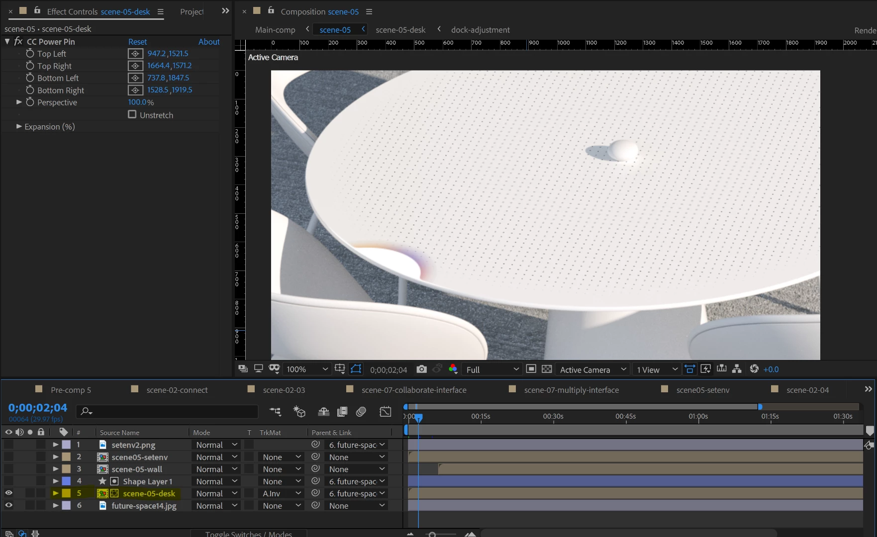

    I'm not sure what is going on because you have not shown us the comp with the modified properties of the layers that are giving you problems revealed. Just select the layers, press U twice, PrintScreen and Paste or drag the screenshot to the screenshot to the forum. I think you are just missing some of the components but I don't have a clue what they may be because you have not given us any workflow details.

    Hi Rick,
    Here's more details about current workflow.
    This is the composition where I have my adjustment layer in, with the other layers that need to be affected.
    And this is the other composition where I'm using the composition shown above.
    Hope this gives you more ideas on what is going on here. Thank you

    Still no modified properties. Select the layers, press the U key twice. I assume that the Scene 05 desk layer is the top composition. You did not show both the switches and modes columns so I can't tell if you have collapse transformations turned on. I also have no idea what is going on in either comp.
    We need a lot more info. There's a 99% chance this is user error.
