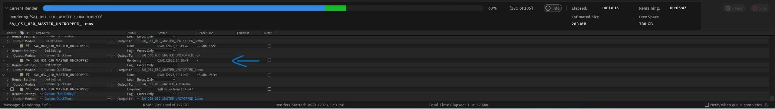

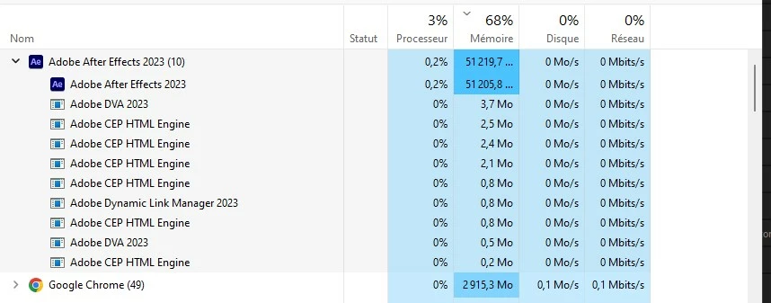

Hello everyone,
I just have a embarassing bug when I am rendering on after effect 2023.1.0 (build 83). I have 128 gig of ram,  an i9 13900K and an rtx 4090 so 24 gig of vram and my composition are in 16 bits , 4k, prores 4444xq,  mostly keying with a few neatvideo v5.5 plugin (on gpu) and one deepglow. the length around 20 to 70 seconds. It's not happening on all the composition but sometimes suddenly during some rendering in "multiframe rendering" it's stopping without crashing and I have to restart after effect . I put below some screenshots. So It's not crashing, it's just stopping to render and it takes me all the time a while to restart after effect ( so shut it down and open a new one) . I just don't know where is it from I feel that it's link to the multiframe rendering and neatvideo but maybe it's a bug from the 2023 . And I don't have any log because it's not crashing.
Thank you in advance.
