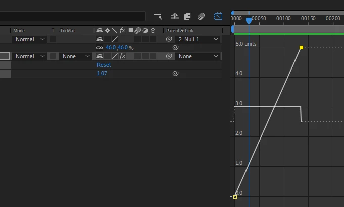

So, I’ve got a Null (Wiggle Null) controlling a whole scene. I’d like animate the wiggle so that it gradually gets more intense.
I’ve currently got the wiggle set up with 2 sliders controlling frequency and amount. This is how it looks:
wiggle(effect("Speed")("Slider"),effect("Amount")("Slider"))
However, when I animate the keyframes, the time between keyframes is filled with a really jolty motion until it reaches the end keyframe!
I thought maybe it was because the numbers on the slider were not whole numbers, so I used this on each slider:
Math.round(effect("Speed")("Slider"))
But to no avail!
Can anyone help? What am I doing wrong?

Maybe your keyframe interpolation is messing up. Go to the graph editor and check out what's happening.
If it's choppy, try seelcting your keyframes and right click > "Keyframe Interpolation" and set all to Linear.
If that doesn't do it, could be some sort of framerate issue. Make sure your comps / precomps are the same framerate.
