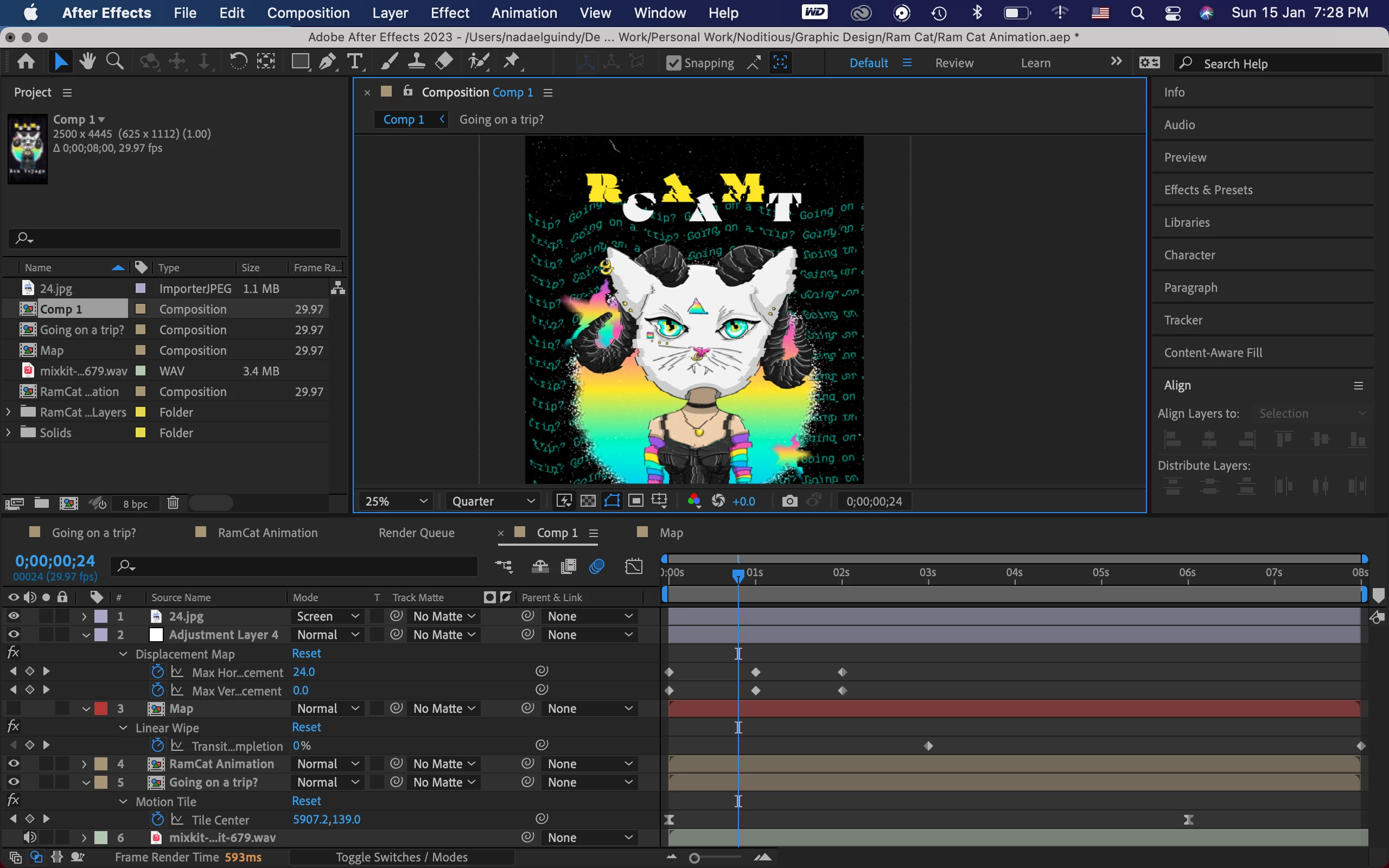

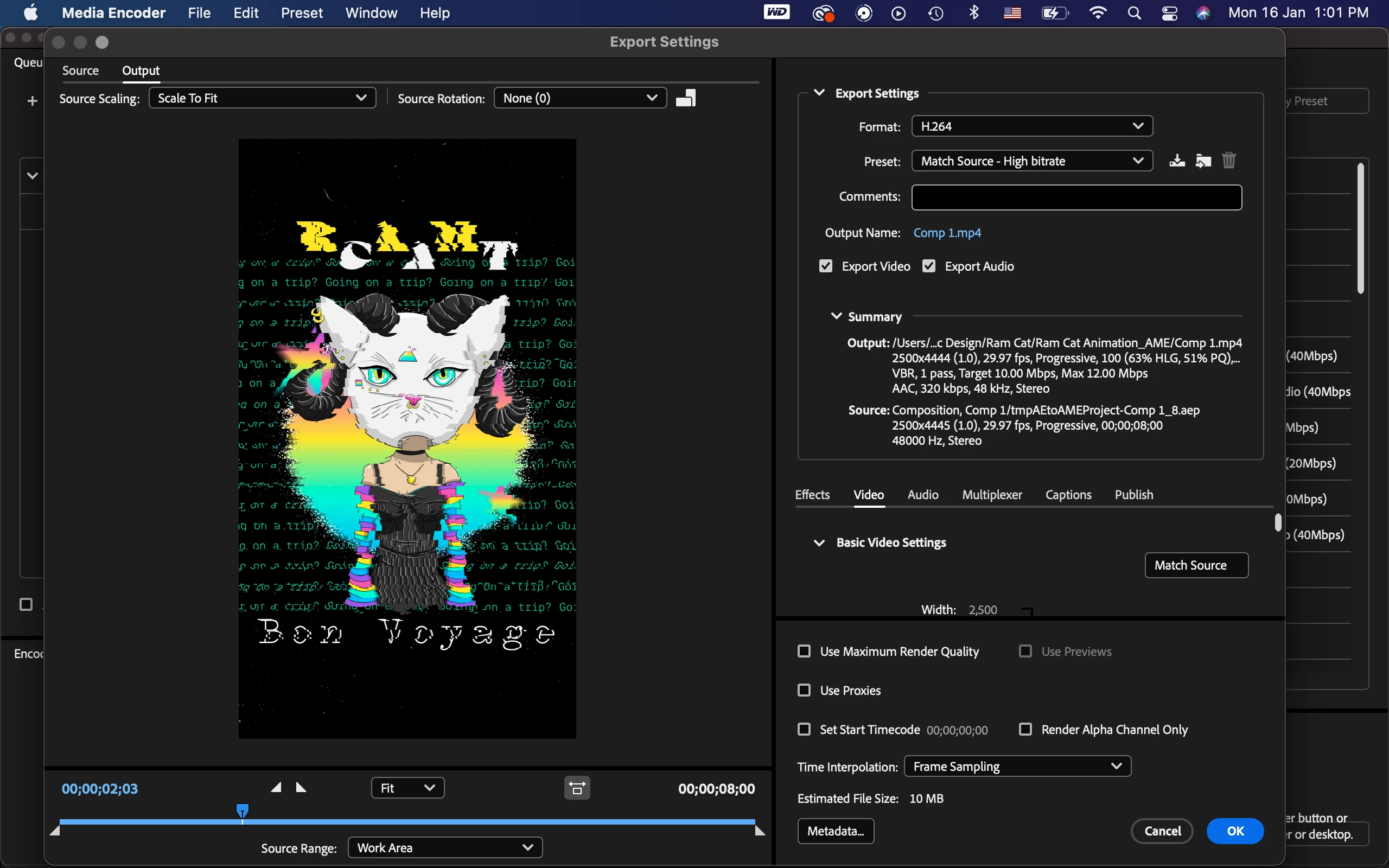

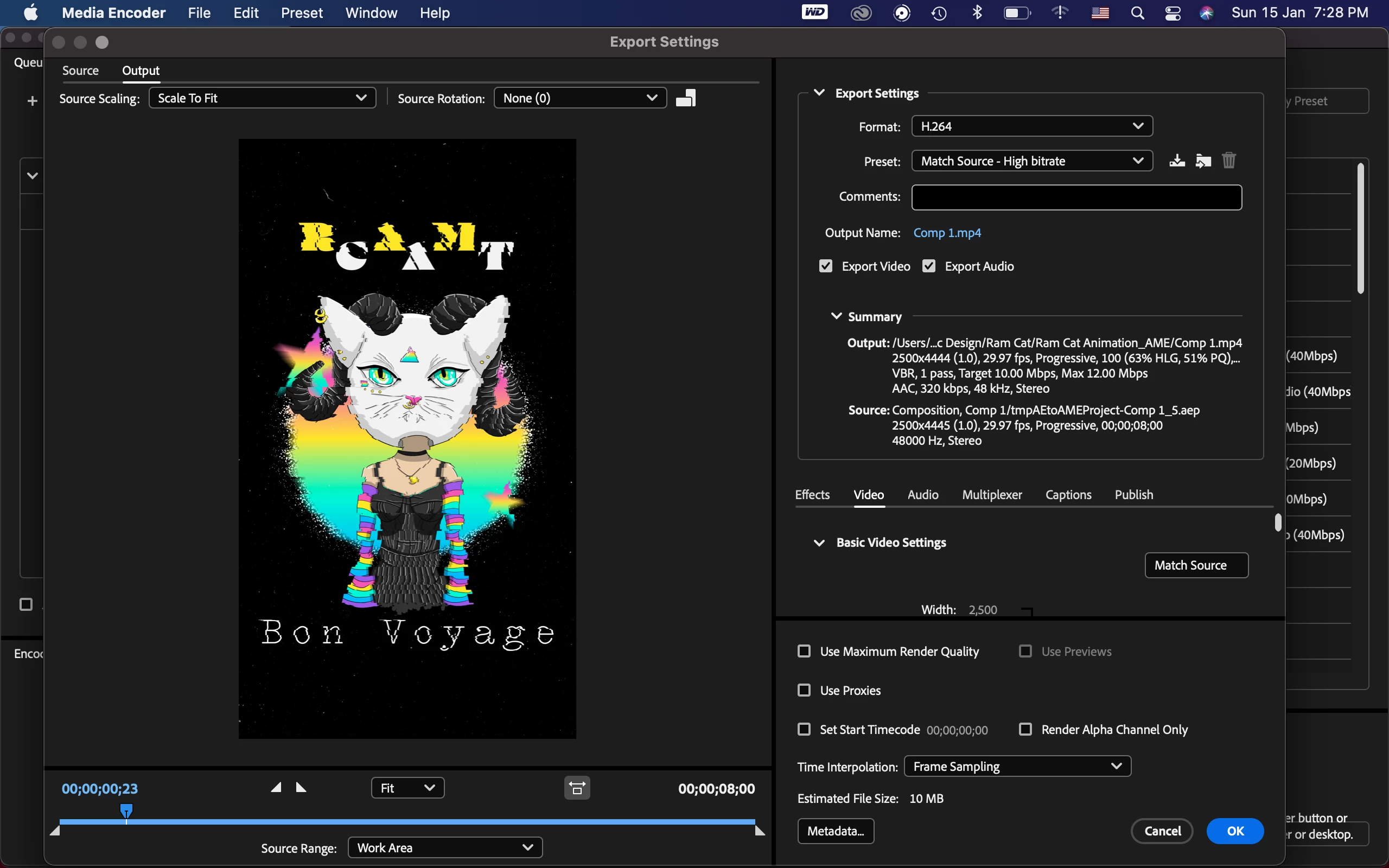

Hello, I was working on this project and after trying to render it, I realised the pre-composition for the type animation was not showing up in the final render, I tried rendering it in after effects and adding it to the media encoder and still nothing seems to help. I am not sure where the issue is, mind you that I recently updated the program to the 23.1 version not sure if that is the problem. I tried purging the cache nothing really changed. The operating system I am using it with is macOS Big Sur Version 11.7 not sure if it is a compatibility issue with the render engine or something else as it worked fine before the update.

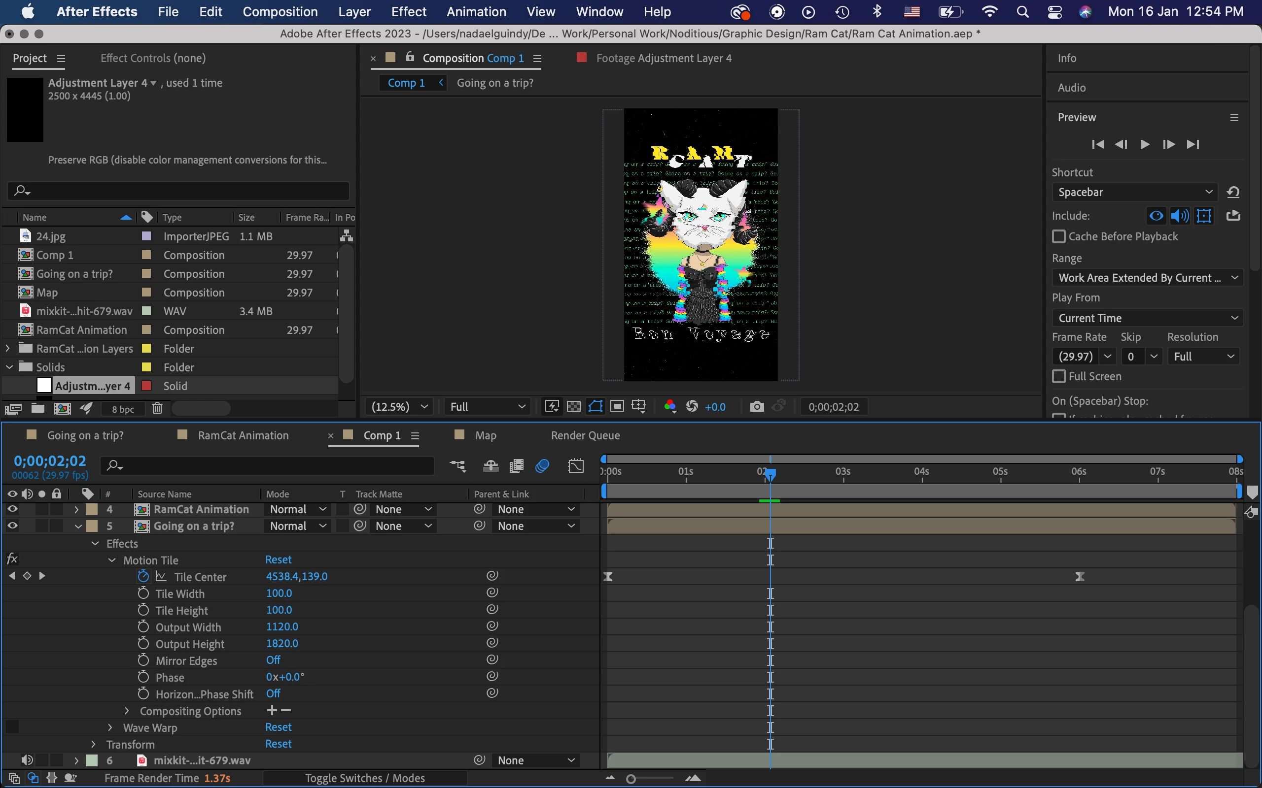

I tried that but nothing seems to change so I decided to downgrade to the previous version I had of after effects but I realized that it seems that it is not the motion tile effect that is causing the issue but rather the wave warp when I turned it off the type shows in the render now

I tried to play around the wave warp effect it seems that the antialiasing was causing this, the problem happens when I have it at high but works if i switch to medium, not sure what that means but it seems to work now, thank you so much for your help!

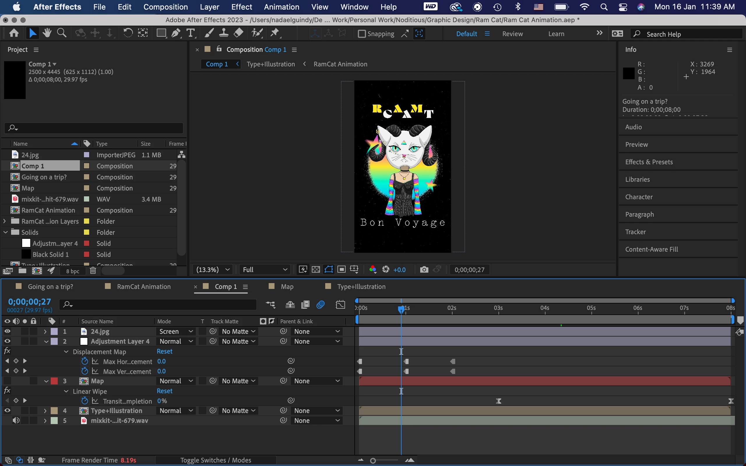

Have you tried pre-composing your background as a whole? Possibly your combination of displacement mapping and motion tile causes some weird behavior. Also start by checking your work at 100% zoom and full resolution. Your comp is quite large and viewing it at quarter resolution could be obfuscating any serious issues.

Thank you, I tried precomposing the two layers together but the problem still seems to presist. I did try the 100% and full resolution and you were right the problem shows in the preview when it is at full resolution, not sure what the cause of it is though.

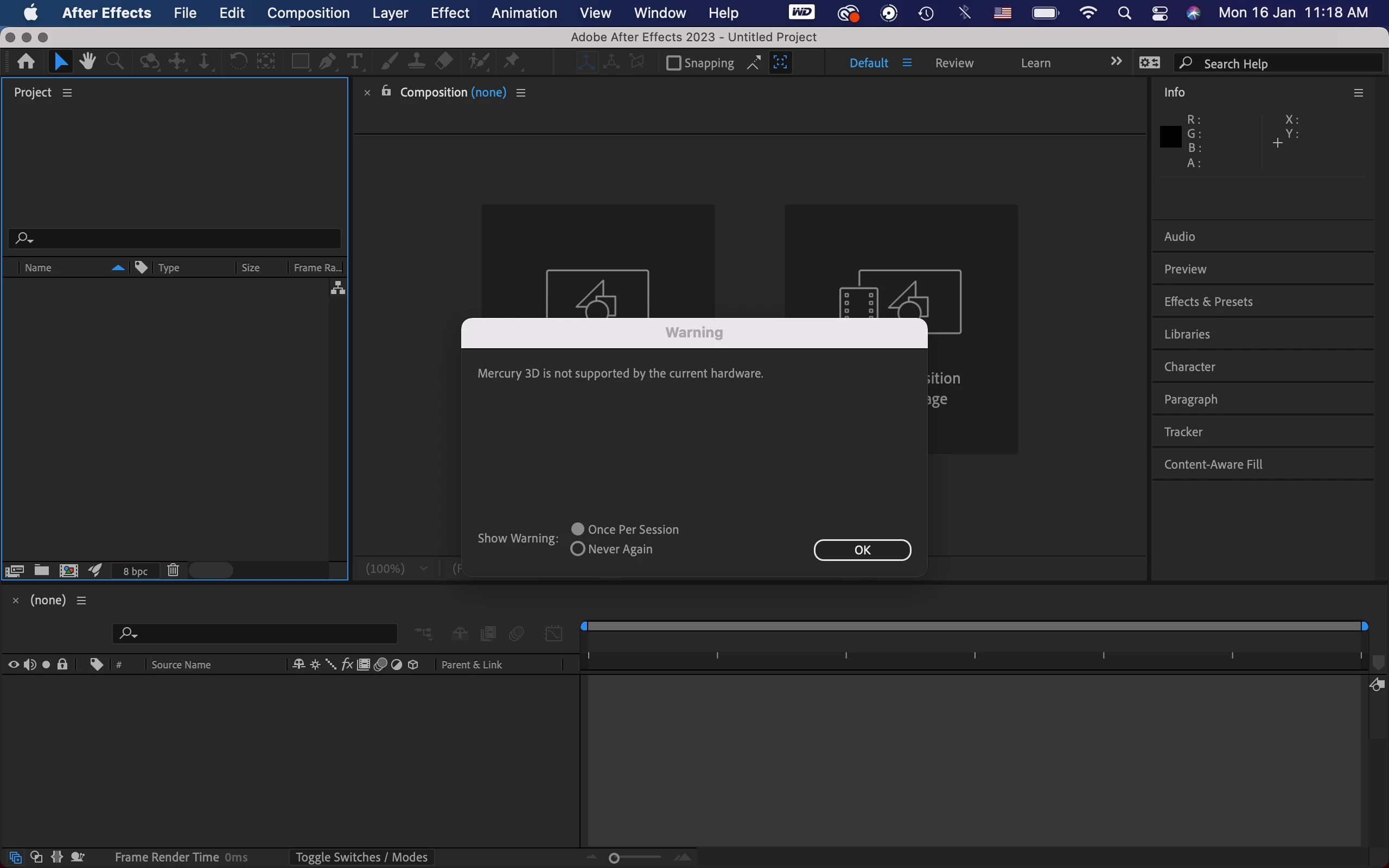

I did try uninstalling and reinstalling the program and i noticed that it was displaying this warning i attached at the startup, not sure if that could be the cause.
