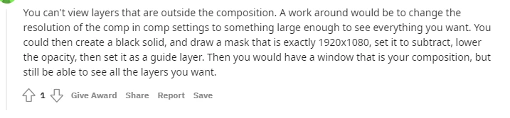

So i have information out side my composition, so i heard the only way to view that information is to resize the comp and then create a mask of exactly 1920 by 1080. I have resized the comp so that everything fits but now I need to make it a size of  1920 by 1080.
I tried to follow the below method but, i cant find a way to use a pen to create an exact 1920 by 1080 mask. I know the shape tool has some measurements but i am confused by the bounded box setting as it doesnt have a typical x and y size.
This was the post you see below i tried to follow.
Cheers guys

Easy solution.  Create a solid that is 1920x1080.  Then double click on the rectangular mask tool in the toolbar.  This will automatically create a mask that is the exact size of the 1920x1080 solid layer.
Then create a second solid layer, but press the Comp Size button so the new solid is the size of your expanded comp.  Copy the mask from the first solid and paste it into the second solid.  You can delete the original solid if you like. You now have a comp-sized layer with a 1920x1080 mask applied.
Follow the original instructions now: set the mask to Subtract, lower the opacity, and set the layer as a Guide Layer.
