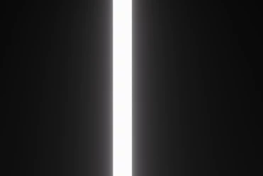

Here's the banding (during playback):

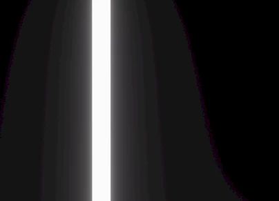

Hitting pause the frame is displayed correctly:

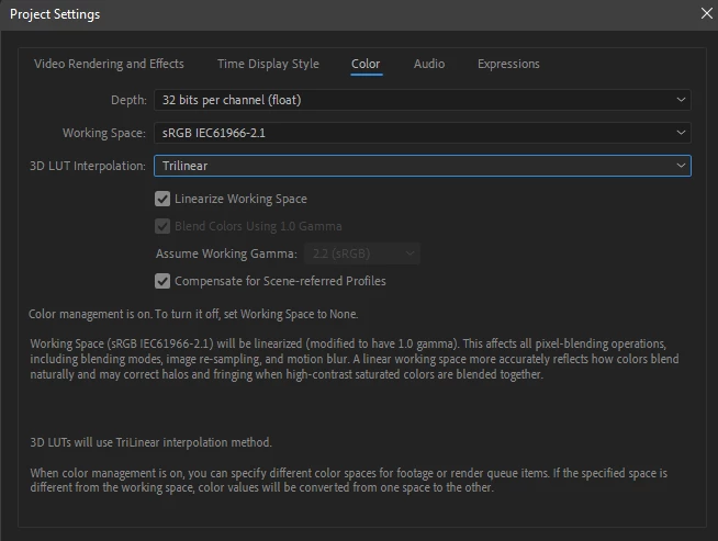

These are my project settings. Also, changing to "none" doesn't fix the problem.

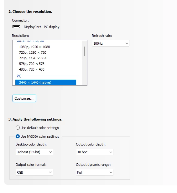

Here are also Nvidia control panel settings:

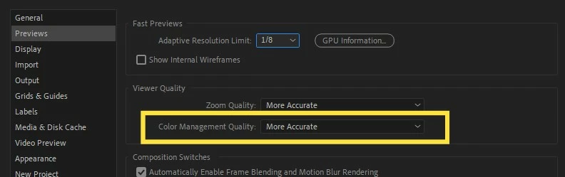

UPDATE:
I accidentally found what was causing this, it's "Color Management Quality" in "Preferences > Previews".
Setting it on "more accurate" solved the problem.

UPDATE:

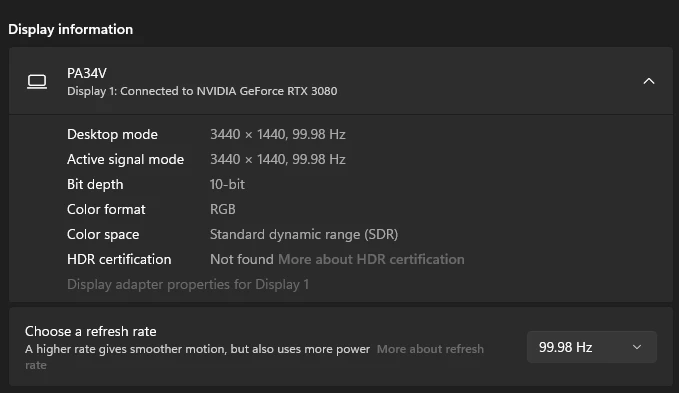

- Display is true 10-bit so that's the 10-bit settings in the Nvidia settings (as I know you need to force it in the nvidia panel to get 10-bit output from Windows otherwise will always output 8bit by default).
- Using factory sRgb preset on the display, which is quite accurate (tested with my probe and displaycal). Not looking for 100% standard so I'm happy with that without having to mess with calibrations.
- Output is via displayport (1.2 so supports 10-bit@100hz).
But the same issue happens also switching to "default color settings" and removing all "forced" nvidia settings, so maybe color profile or nvidia settings are not part of the problem.

I usually work at 1080p / 25fps / 32bit, color management settings sRgb (linear off) as posted above.
I add linear if I'm working with linear .exrs exported from cinema.

Windows 11 display settings

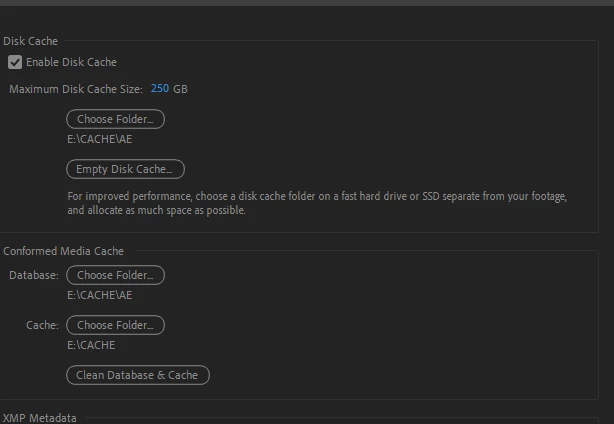

I didn't think that cache or ae settings can be part of the problem, here's the settings.
Cache is on a separate dedicated m.2 drive
