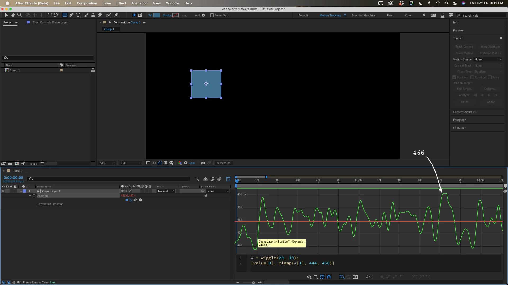

Wiggle will accelerate just past the stated value on occasion. The overshoot depends on the frequency and it can be 1 or 2 pixels. If you want to make sure that the movement hits the hard stops often at 444 and 466 you need to use 11. In this screenshot at 20 cycles per second and a distance of 10 pixels, I only get 2 clamped values with a maximum duration of 3 frames. The larger the amplitude value, the longer the movement will pause. There is almost always a little overshoot when you use wiggle.
