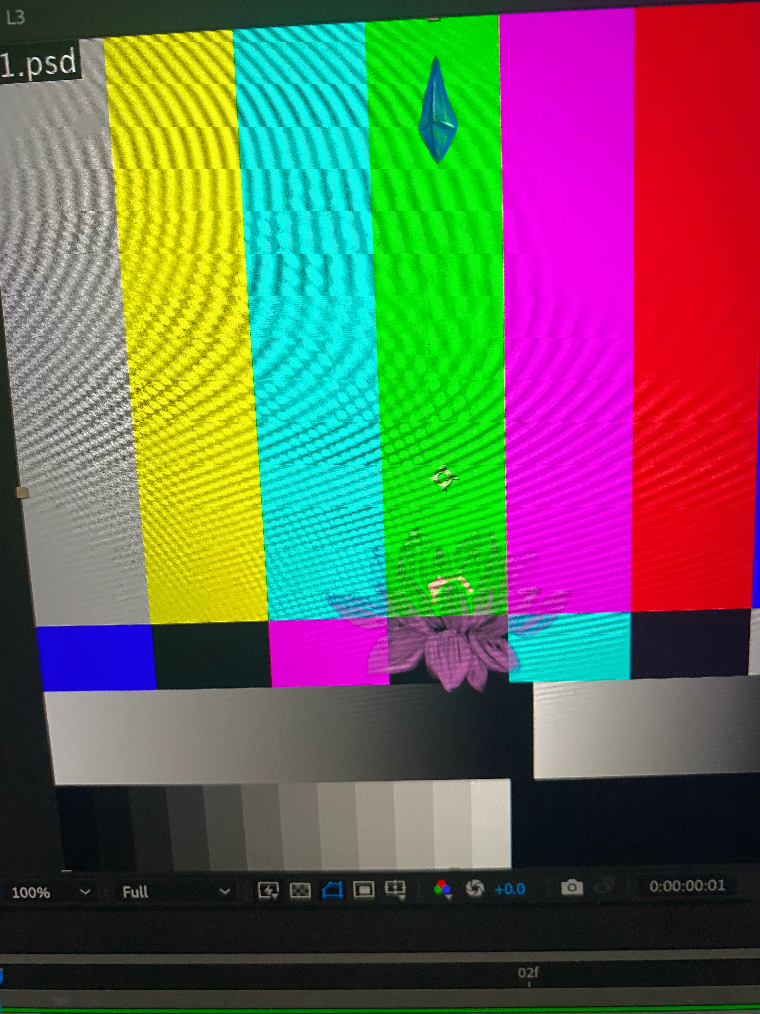

Hello everyone!
Can anyone help me why I get this color bars in AE when I imported psd file, I tried to find any missing files but there aren't.
please help
Thanks!
Correct answer Mylenium
without any specific info about the contents and structure of the PSD we can't really tell you much. such a behavior typically indicates that you may have used a specific unsupported feature like smart objects, smart filters, compley layer styles or deeply nested grouping which would cause AE to not be able to translate them and instead treat them as unavailable content.
