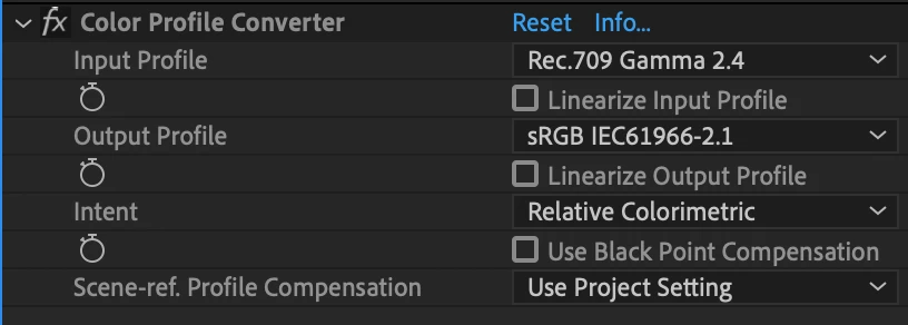

By looking at the source footage properties, it appears to be rec.709 gamma 2.4—because it is going on the web, I assume it needs to be converted to sRGB 2.1 (again, could be wrong here). I have tried manually converting it via both the "interpret footage" method, and the "color profile converter" adjustment layer method (attached). I am less concerned about the exported footage matching the source, as I am about the exported footage and the still image being the same color.

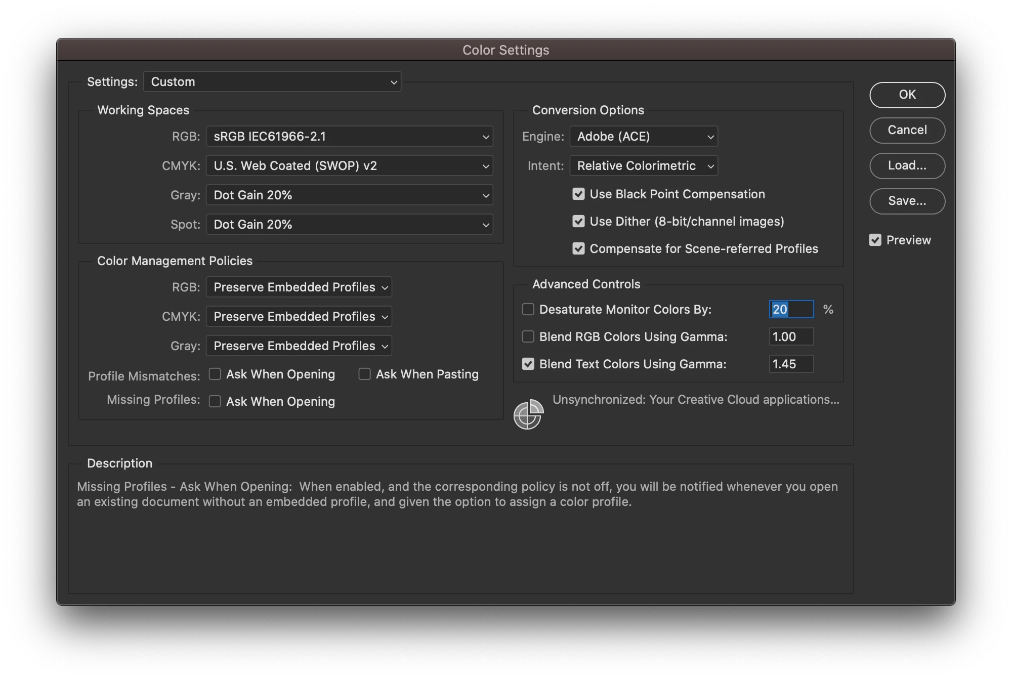

I have also tried using sRGB working CM in AE, exporting various formats. In photoshop, I have it set to sRGB working and to preserve embedded profiles (attached). Because none of the above seemed to be working, I also tried setting the AE CM to rec.709 just to check. I am on a macbook pro using the "Color LCD" profile.
