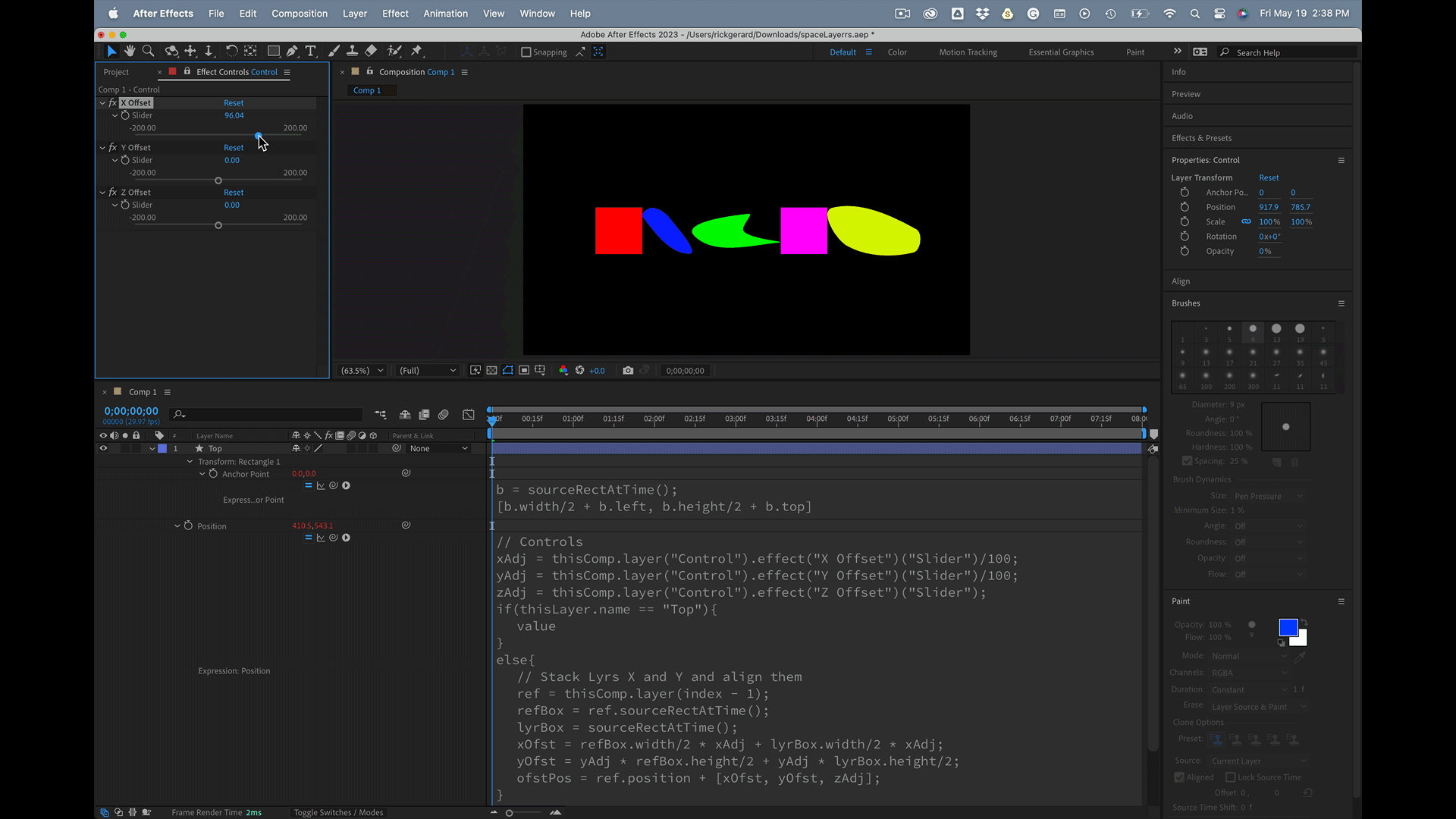

I took a few minutes and created a couple of expressions and 3 Sliders that will stack and offset a bunch of other shape layers. A controller layer is needed, and, to prevent expression errors, the top layer in the stack must be named Top, but that's easy.
If you are going to stack layers based on their size, the first thing you have to do is fix any Anchor Point problems. Shape layers have a Shape/Transform Shape property. This expression is added to Contents/Shape/Transform Shape/Anchor point:
b = sourceRectAtTime();
[b.width/2 + b.left, b.height/2 + b.top]
The property could be Contents/Rectangle 1/Transform Rectangle 1/Anchor Point or Contents/Shape 1/Transform Shape 1/Anchor Point.
When you apply that expression to a shape layer, unless the Anchor Point is already in the center of the graphic, the layer position will change.
The next step is to add some Controls/Sliders for X, Y, and Z offset. I used a solid that can be placed above or below the stack of shape layers.
If you start the Position expression with an if statement that checks the layer name and uses the default value for position when the layer name is Top or makes some calculations if the layer name is not Top, you can add this expression to the Shape Layer/Transform/Position property.
// Controls
xAdj = thisComp.layer("Control").effect("X Offset")("Slider")/100;
yAdj = thisComp.layer("Control").effect("Y Offset")("Slider")/100;
zAdj = thisComp.layer("Control").effect("Z Offset")("Slider");
if(thisLayer.name == "Top"){
	value
else{
	// Stack Lyrs X and Y and align them
	ref = thisComp.layer(index - 1);
	refBox = ref.sourceRectAtTime();
	lyrBox = sourceRectAtTime();
	xOfst = refBox.width/2 * xAdj + lyrBox.width/2 * xAdj;
	yOfst = yAdj * refBox.height/2 + yAdj * lyrBox.height/2;
	ofstPos = ref.position + [xOfst, yOfst, zAdj];
The X and Y offset sliders work on a percentage of the current layer's height and width. When the sliders are set to zero, the layers will stack on top of each other. As you adjust the X and Y slider until the value for either is 100%, the layers will be perfectly lined up edge to edge. The Z slider does nothing until you make the Shape Layers 3D. Then it just offsets each layer by the value you set with the slider.
I think this will do everything you want to do. With some modifications, the math will also work with text layers or a combination of text and shape layers.
I hope this helps. I have uploaded a project file.
Rick GerardCommunity ExpertCorrect answer

May 19, 2023
Morning Rick,
 Thank you for taking the time to buid this and write up an explanation. I can see I wasn't even the ballpark of being correct.
 I've already put this into my project and it's working really well.
Thanks again for the help.

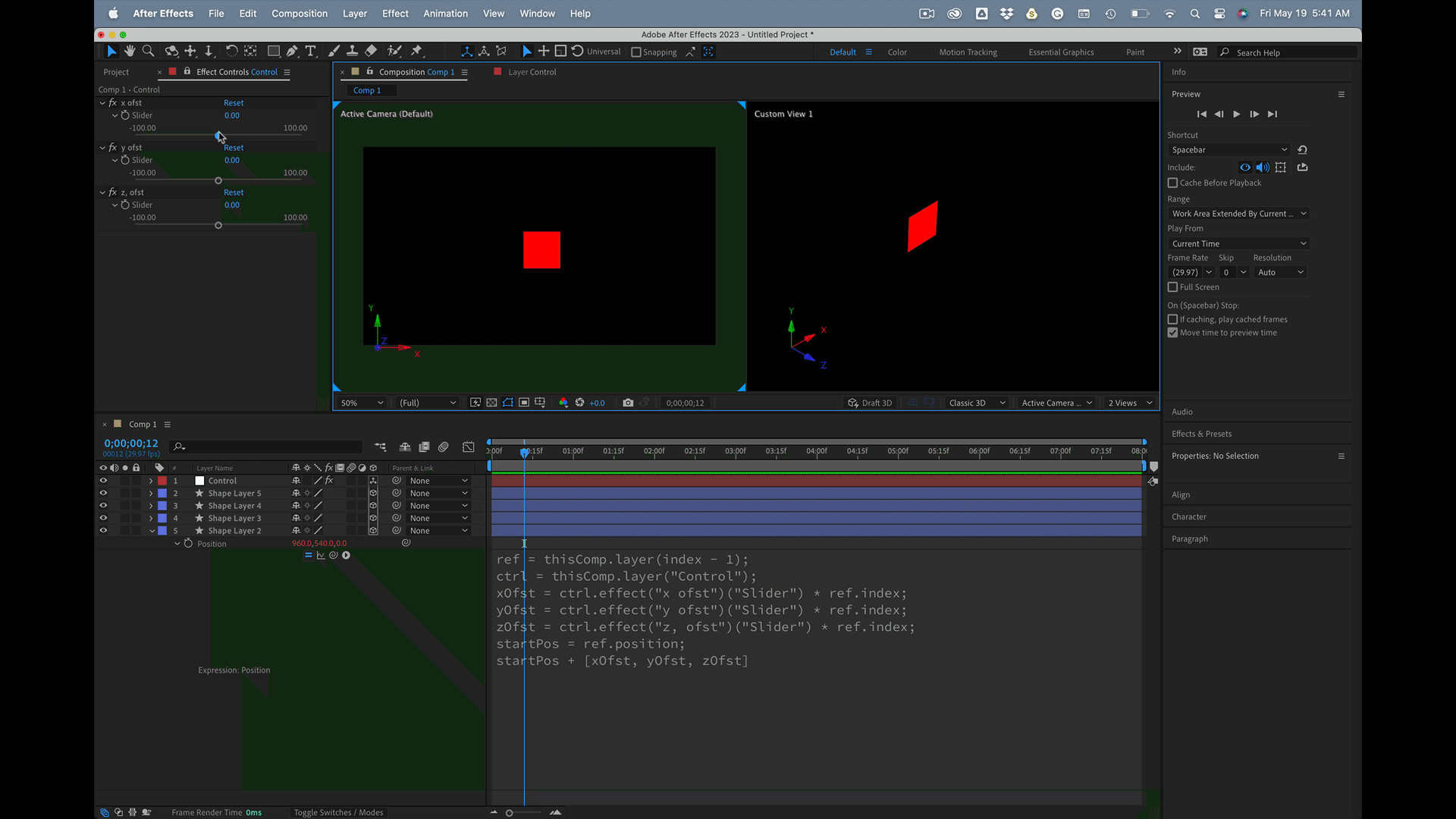

May 19, 2023
The expression offsets each layer in X, Y, and Z. It's just not very useful. Did you copy it correctly?
Here is a more useful 3D layer stacking option. 3 sliders instead of one, multiplied by the index of the layer.
ctrl = thisComp.layer("Control");
xOfst = ctrl.effect("x ofst")("Slider") * ref.index;
yOfst = ctrl.effect("y ofst")("Slider") * ref.index;
zOfst = ctrl.effect("z, ofst")("Slider") * ref.index;
startPos = ref.position;
startPos + [xOfst, yOfst, zOfst]
There is no need for sourceRectAtTime() if you are only offsetting the position unless you want to base the offset on the size of the layer. All you need to create a cumulative offset is to multiply the offset distance by the layer index.
Your first expression does not move the layer's x value based on the layer index. It just offsets each layer in X by a portion of the width and offsets the layer in Y based on the slider. There is no need to fiddle with toComp or toWorld to build an effective layer-stacking expression.
