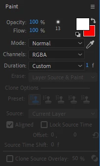

Easiest and most efficient: Use the Window/Workspace/Paint menu
This will give you a layout designed for using the paint tools, and the Layer Panel will be on the Right, the Comp panel on the left so you can see what your paint looks like in the comp while you work on a layer.
Another option is to open the Window menu and select Paint from the list of available panels.
