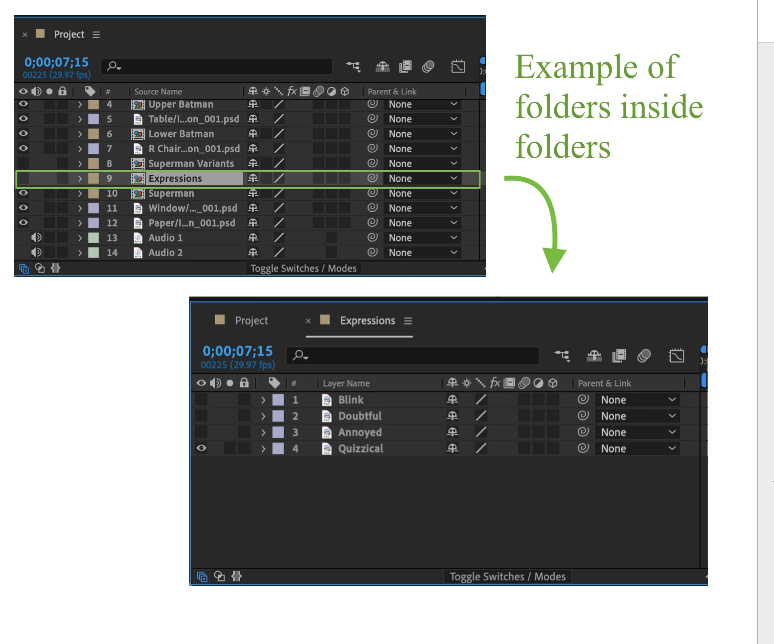

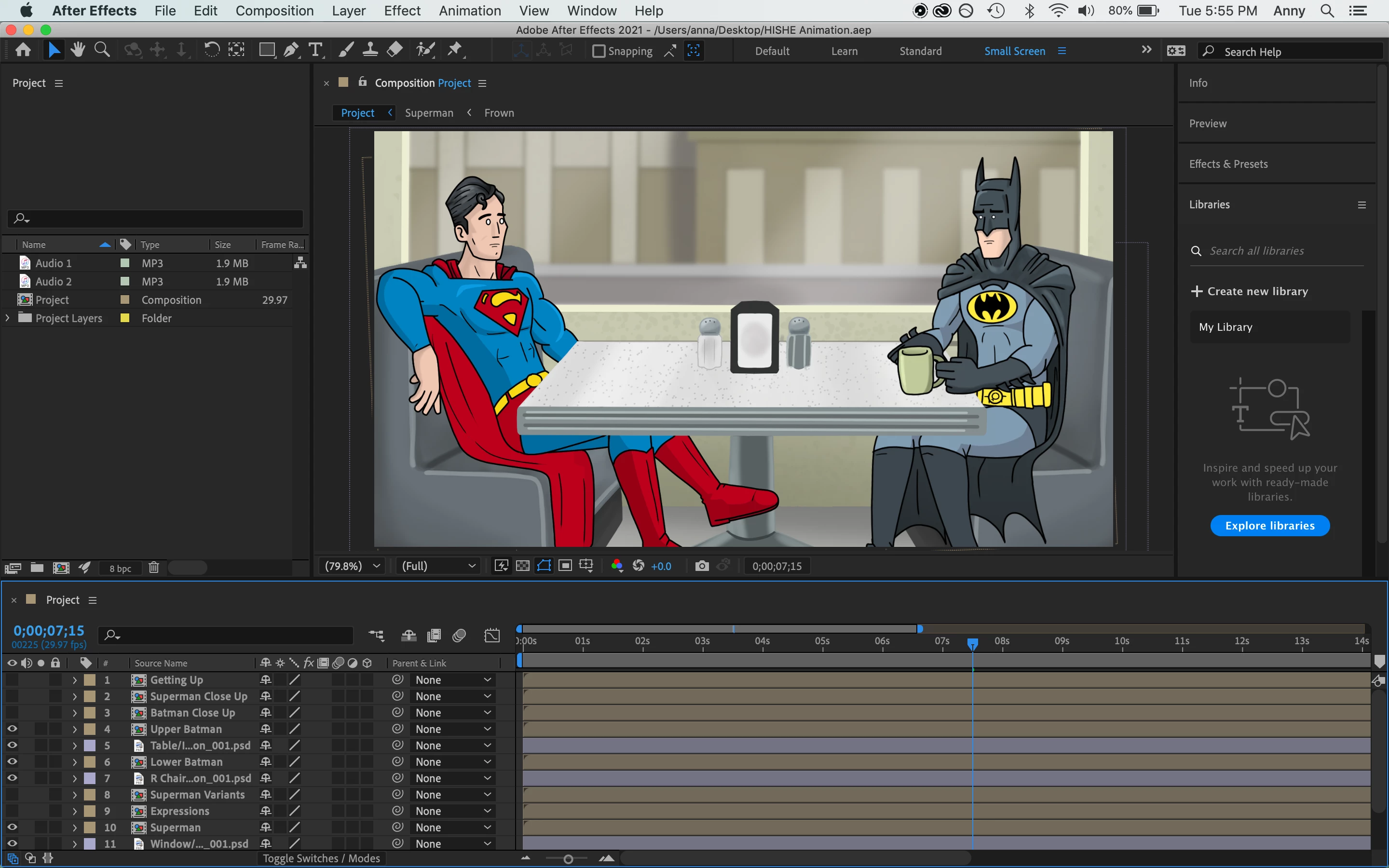

I have attached some screenshots of my workspace. (The animation may look familiar. I am modeling it after the YouTube channel How It Should Have Ended, as I am applying to them for an internship.) As you can see, I have multiple folders, which are inside more folders. Is this a helpful setup, or am I complicating things?

For your future reference / searching - what you're referring to as "folders" are Compositions. When they're used as an element within another composition, they're referred to as a Pre-Composition, or "precomp."
This is the kind of setup I'd likely use for a project like this, though I can see how it would be confusing if you're a newer user. Was this project provided for you, or did you create all this from scratch?
Based on what you've told me, I think careful use of keyframing Opacity on the different desired layers (making sure they're actually one frame apart), and/or using Hold keyframes should be the answer to the question you're actually asking here. I have a feeling you're going to encounter several more questions in a complex project like this, but we'll be here when that time comes!
For what it's worth - if built correctly (large enough), you could also do your "cuts" just using one model of each character. Using a Null Object, you could parent all your layers (that aren't already parented to something else) to it, and use that like a "camera," for Position/Scale. Hold keyframes, like I referenced above, would be the key here if you want cuts vs moves.
