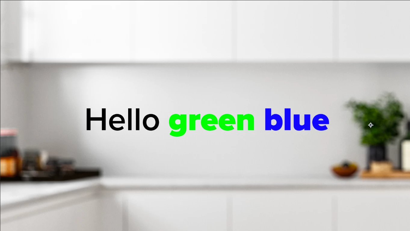

One way of doing it is to have one text layer, where the text is black for just text, green for image cutout a, and blue for image cutout b. Then put the image layers ON TOP OF the text layer. And apply some kind of key effect NOT on the text layer, but on each image layer, but let the key plugin look at the text layer below. Is there a key effect that can do that? Or is it possible to make Keylight do this with scripting perhaps?

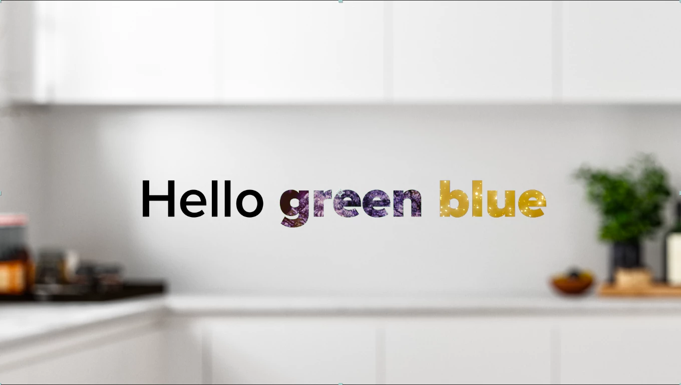

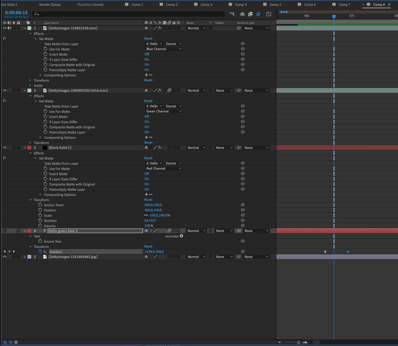

December 22, 2021
Hi again,

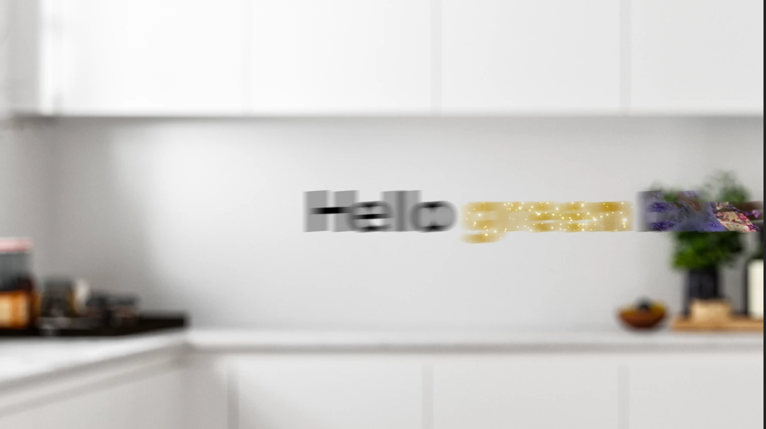

I ended up using the Set Matte effect. The blur looks better that way. See images. Thanks for your comments. It helped me very much in thinking in new ways.

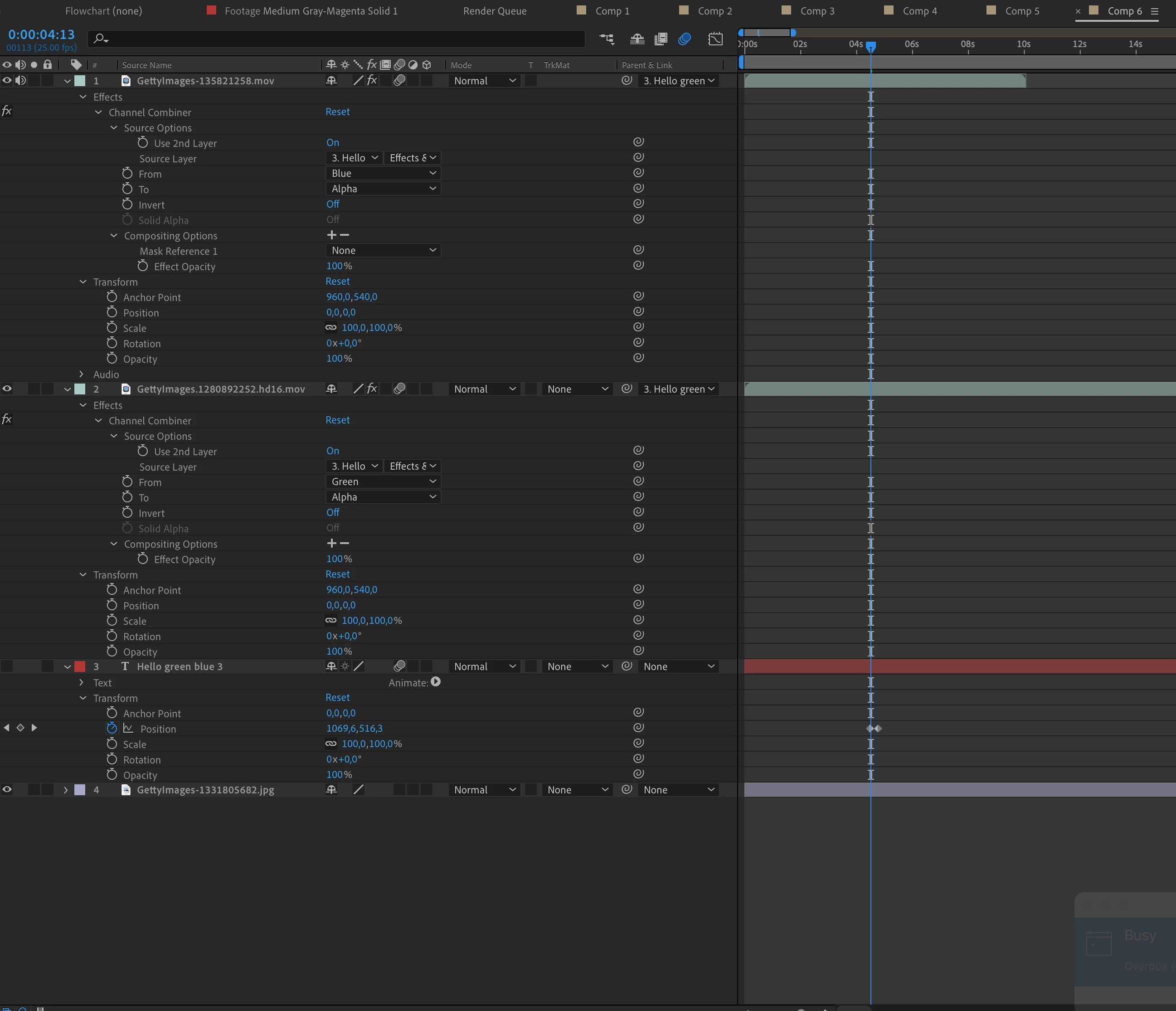

Effects --> Channel --> Channel Combiner
Effects --> Channel --> Set Channels/ Shift Channels
Of course you may not be able to avoid some extra masking in some situations, but assuming your RGB matte encoding works, that's all you should need. just keep in mind that the logic is reversed - you apply the effects to the fill layers referencing the text, not the other way around.
Mylenium
December 15, 2021

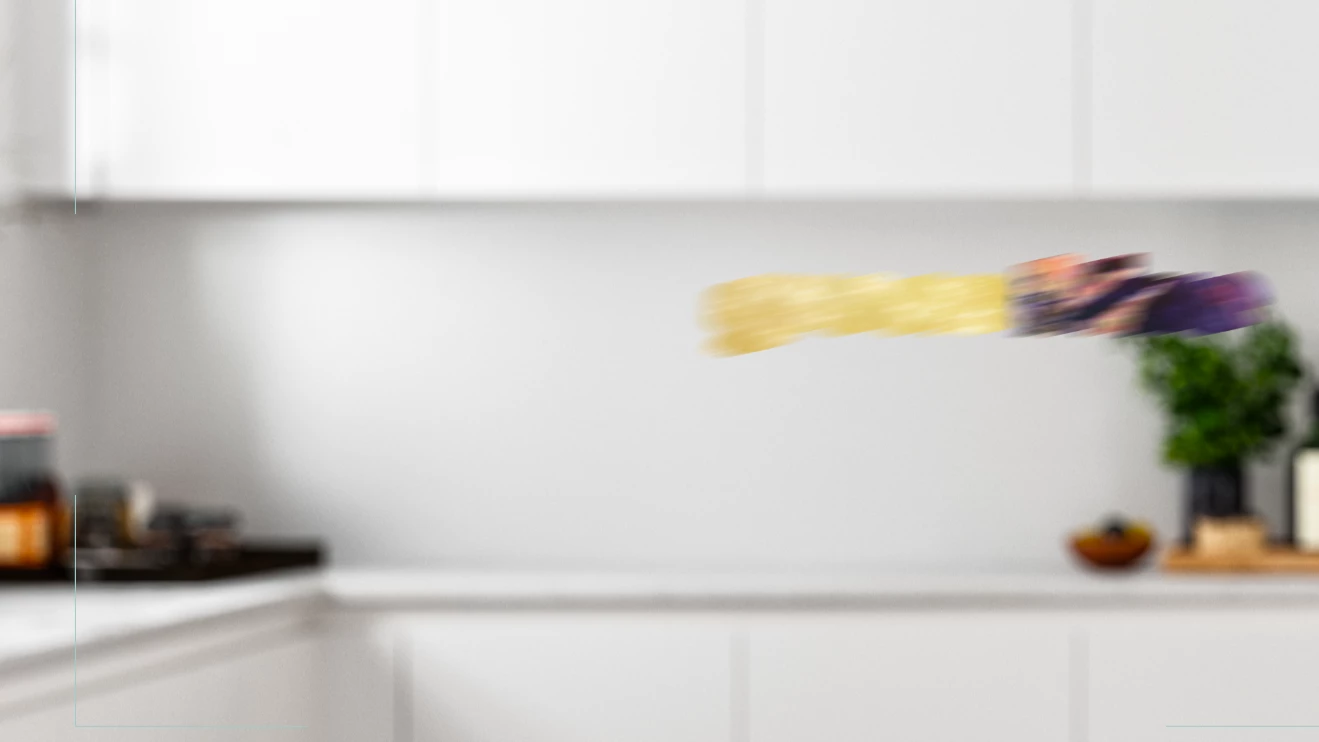

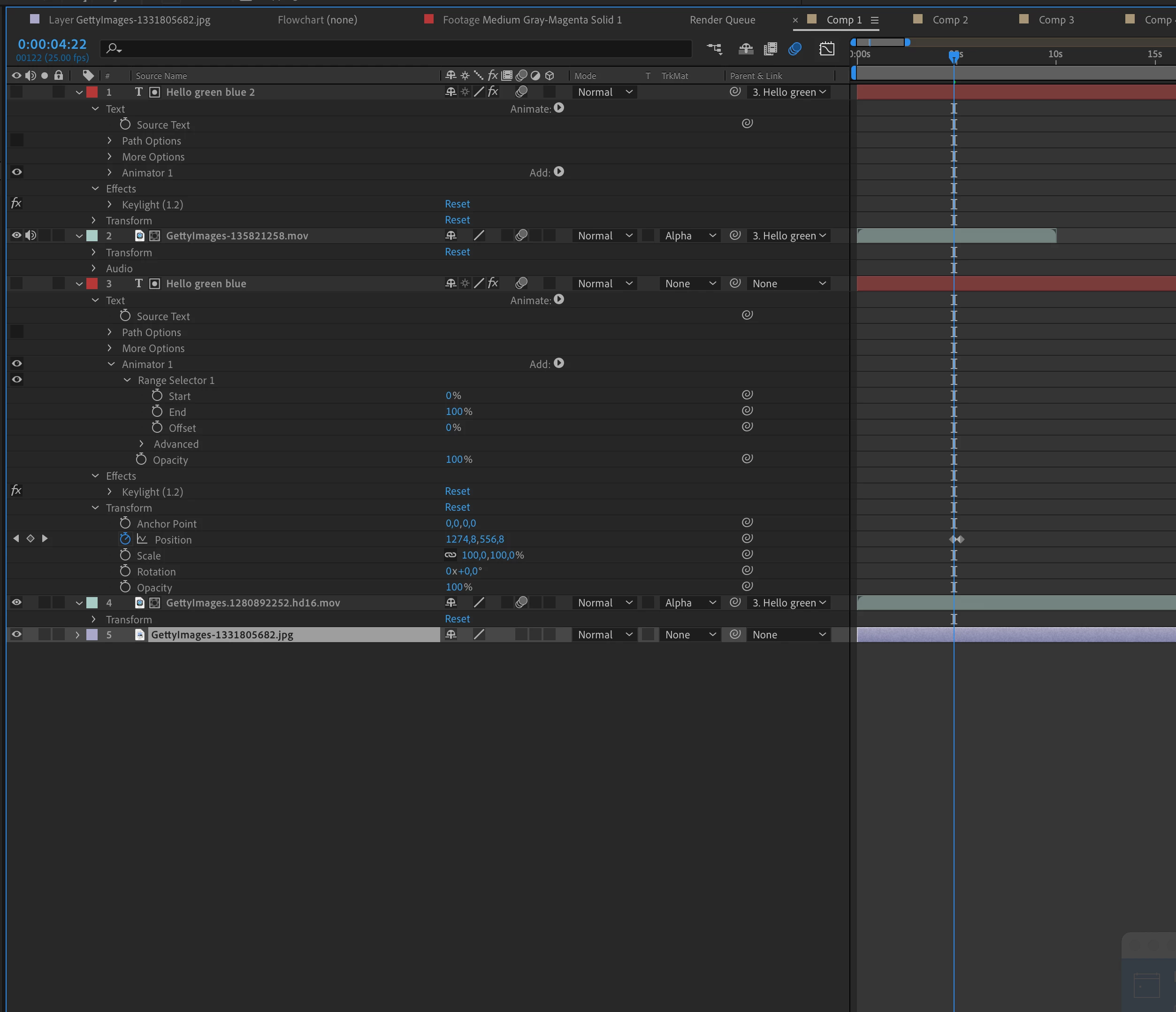

Thank you very much for your answer! It worked! There is still one thing that does not look as good with this solution, and that is motion blur. Do you have an idea why? And is there an easy fix for that too?
The first two images is with one text layer per overlay. Video source layer underneath each text layer.
The last two is with only one text layer. Video source layers all on top of text layer. Not as nice blur...
Thanks! Markus
