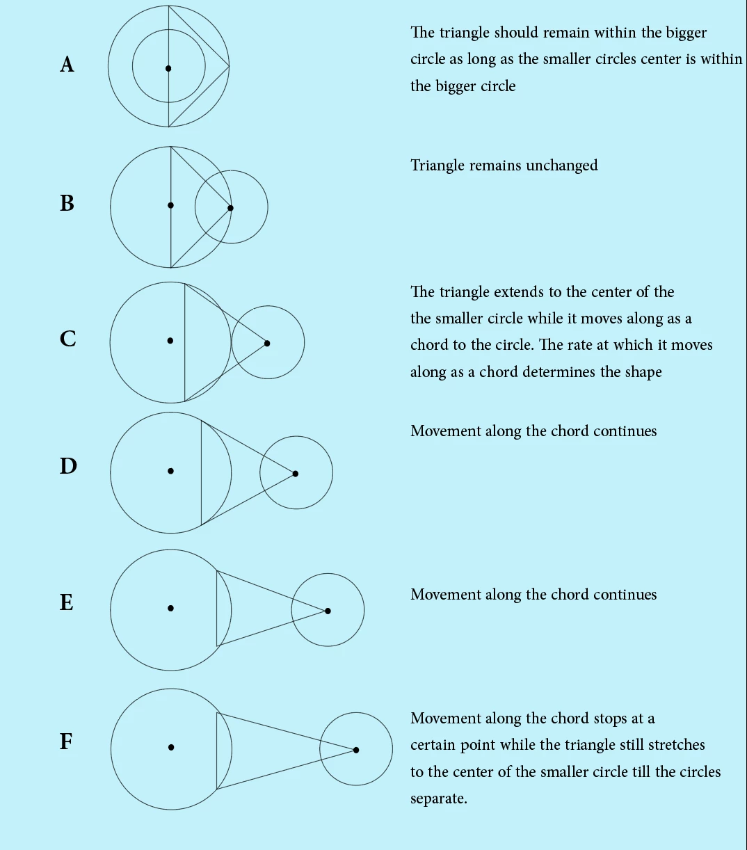

I am quite new to After Effects. I am trying to move a triangle along the chord of one circle and the center of another. Moving the smaller circle from the bigger one is not an issue, but how to transform the triangle to change shape between the circles is an issue for me. Please see the image below which gives a better idea of what I want to achieve. I would really appreciate some help.

From your explanation this looks like a very difficult problem to solve mathematically. Unfortunately the polygon tool in After Effects does not let you set the length of the individual sides of a triangle. What you can do is break the link between x and y scale values and animate the scale of the triangle layer so that it follows the contour of the circle. This will require 2 keyframes for position for the small circle and the triangle, three keyframes for scale on the triangle and some modification of the temporal curve using the graph editor to make things line up.

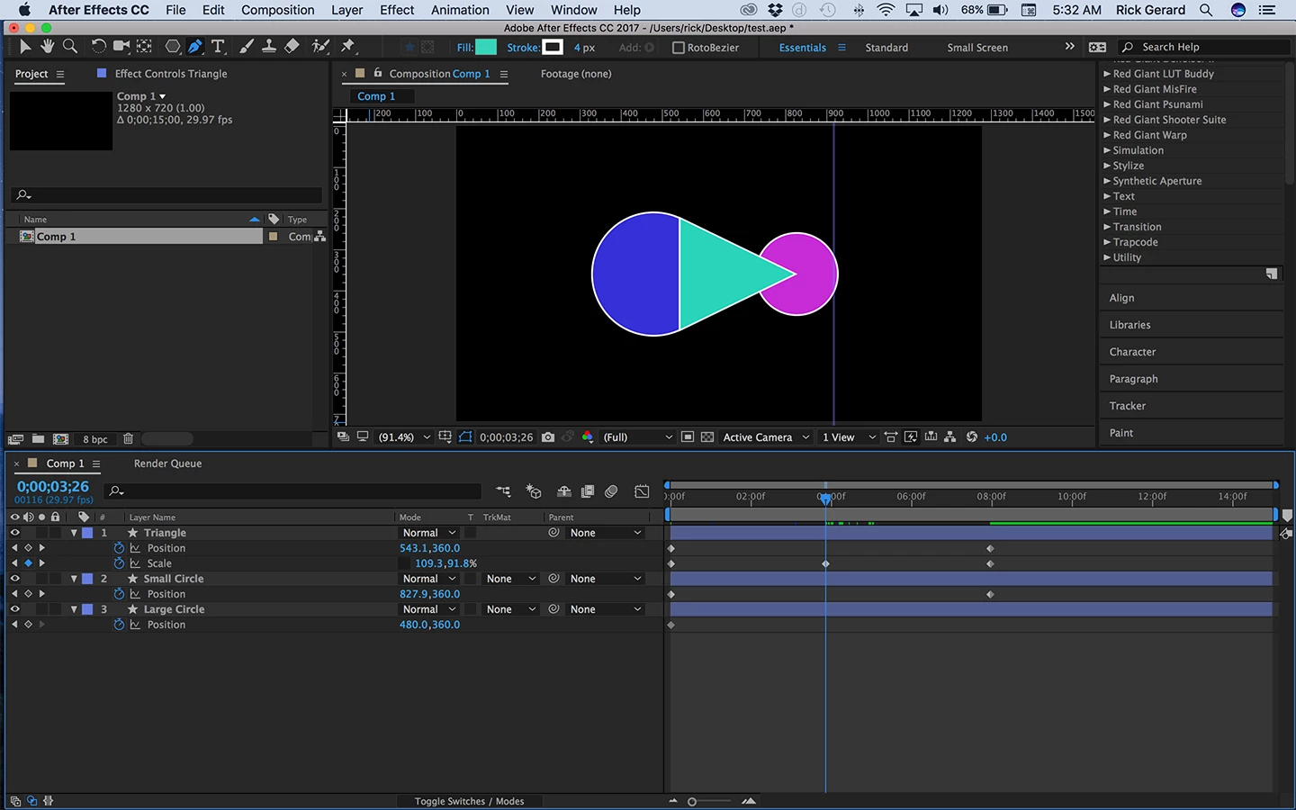

With no layers selected press the u key once to close all of the modified properties in the timeline then hold down Alt/Option and press p to set an initial keyframe for all layers position. Select the triangle layer and press Shift + Alt/Option + s to set a scale keyframe for the triangle layer. You should now see all of the properties we are going to animate in the timeline.
Move down the timeline and move Circle 2 (small circle) to it's ending position by dragging the x value in the position property. Then move the triangle into it's final position by doing the same.

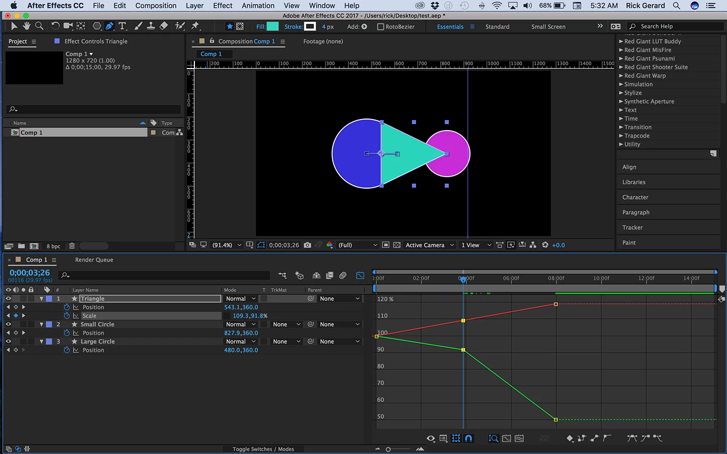

Here comes the fun part. Unlink the scale property on the Triangle layer by clicking on the little chain link icon ∞ in the timeline and then adjust the Y scale value until the vertical side if the triangle lines up with the outside of the larger circle. Again using a high Magnification Ratio makes this easier. Also, when you get close to the right value by dragging the y scale value in the timeline you can press the Ctrl/Cmnd key to give you more control over the values. When you get the height of the triangle adjusted edit the X value of scale to move the apex of the triangle to the center of Circle 1 (small circle).

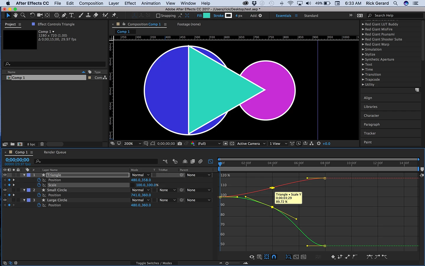

The last step is to position the CTI (current time indicator) about half way between the start and ending keyframes and set a new keyframe for Y scale. Match up the vertical size with the outside of the circle then open up the graph editor. Make sure you have edit value graph selected. When you select the Triangle scale property you'll see two lines. The green one is the Y value. Choose the pencil tool (type g) then hold down the Alt/Option tool to bring up the convert point tool (it looks like a sideways v) and drag out a bezier handle to create a smooth curve. Drag the CTI through the timeline to check verify that the vertical side of the triangle accurately follows the outside of Circle 1. You will probably have to break the tangent on the Y curve by using the convert point tool and grabbing the left handle.

Initial keyframes:
Before adjusting scale graph:
Adjusted scale graph:

Initial keyframes:
