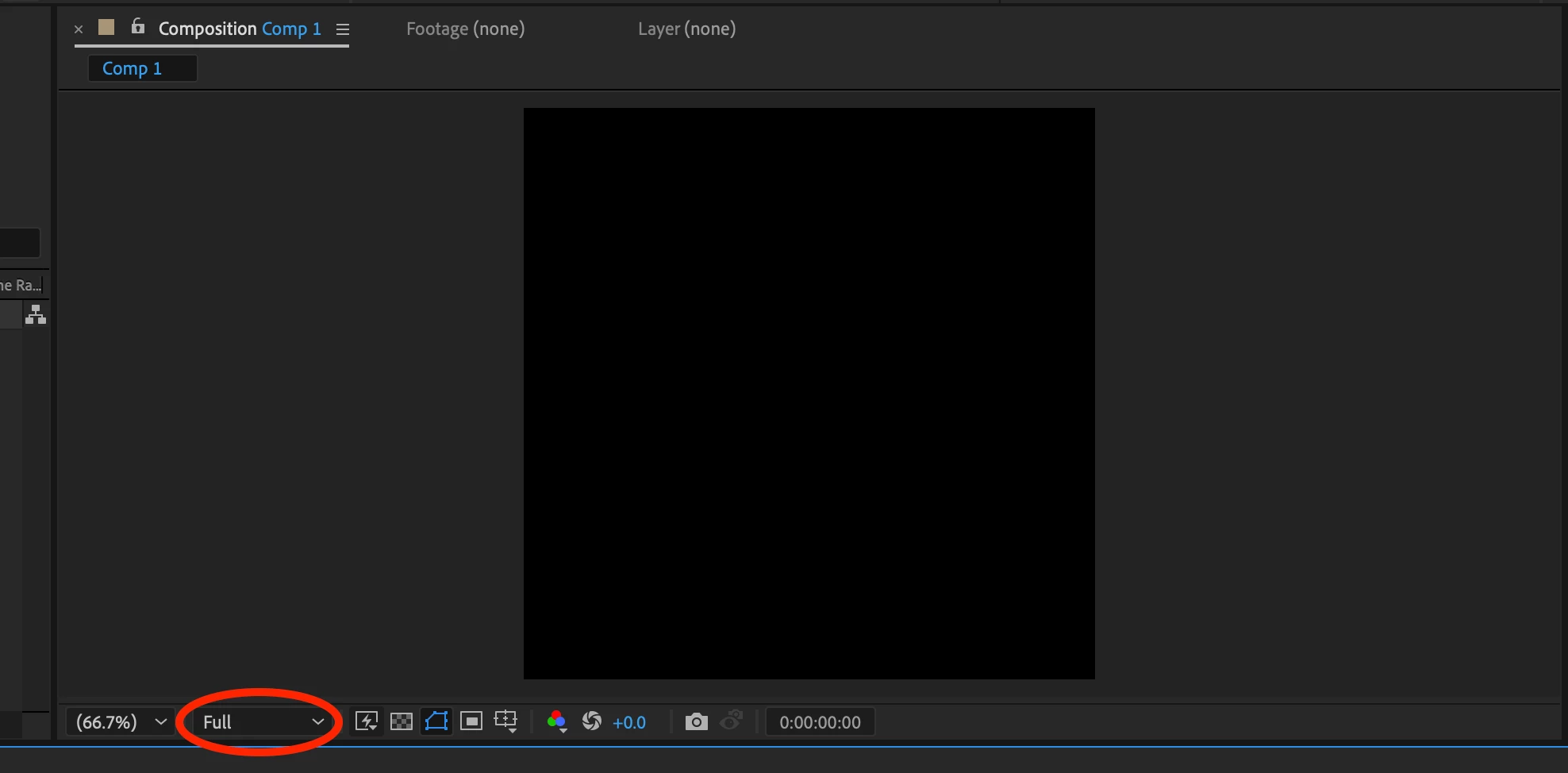

Try enabling Continuously Rasterize for the AI layers in case you're changing the scale of the AI layer in AE. (check the link for more detail -https://www.schoolofmotion.com/blog/collapse-transformations-continuously-rasterize-after-effects)
In case your not scaling the AI layers in AE, then it could be the issue of preview resolution to half or lower (know as sample factor in the composition panel)...check for the same and make sure it is set to Full.
Refer to the screenshots below -
