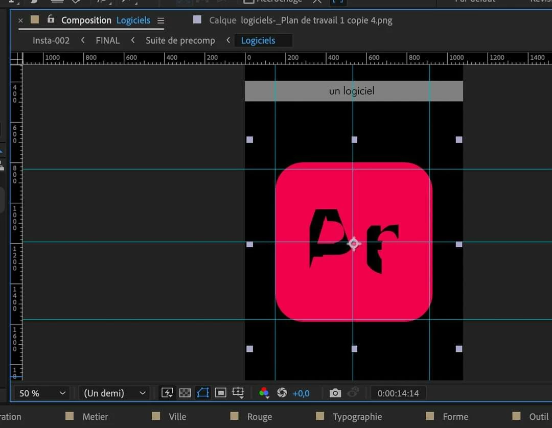

En effet, je souhaiterais afficher des éléments seuls dans ma composition mais certains se superposent avec des images fantômes qui ne sont pas sur la timeline à ce moment précis.
Pour l'exemple, j'aimerais afficher le logotype seul de Premiere Pro mais celui-ci est superposé à un autre logotype... Hors, ce deuxième élément n'apparaît pas sur la timeline et je ne peux donc pas l'enlever puisque je ne comprends donc pas d'où il sort...

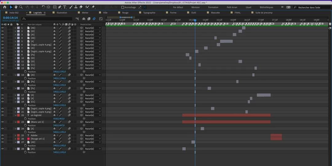

It simply seems you don't understand how AE's temporal sampling works and your layers are not trimmed accordingly. Your AE and Premiere logos overlap by at least one frame in your timeline even if the weird stacking order makes it hard to see. And that kind of is the problem: Your timeline organization leaves a lot to be desired. You would probably be a lot less confused if you actually put layers that are supposed to transition from one to another next to each other, not with ten layers inbetween. then it would be easy to detect such problems.

the screenshot you post is not good enough to understand the issue, but my suggestion is to solo the layer you want and check if you're issue is fixed than start checking every layer to see which layer affects your final output
