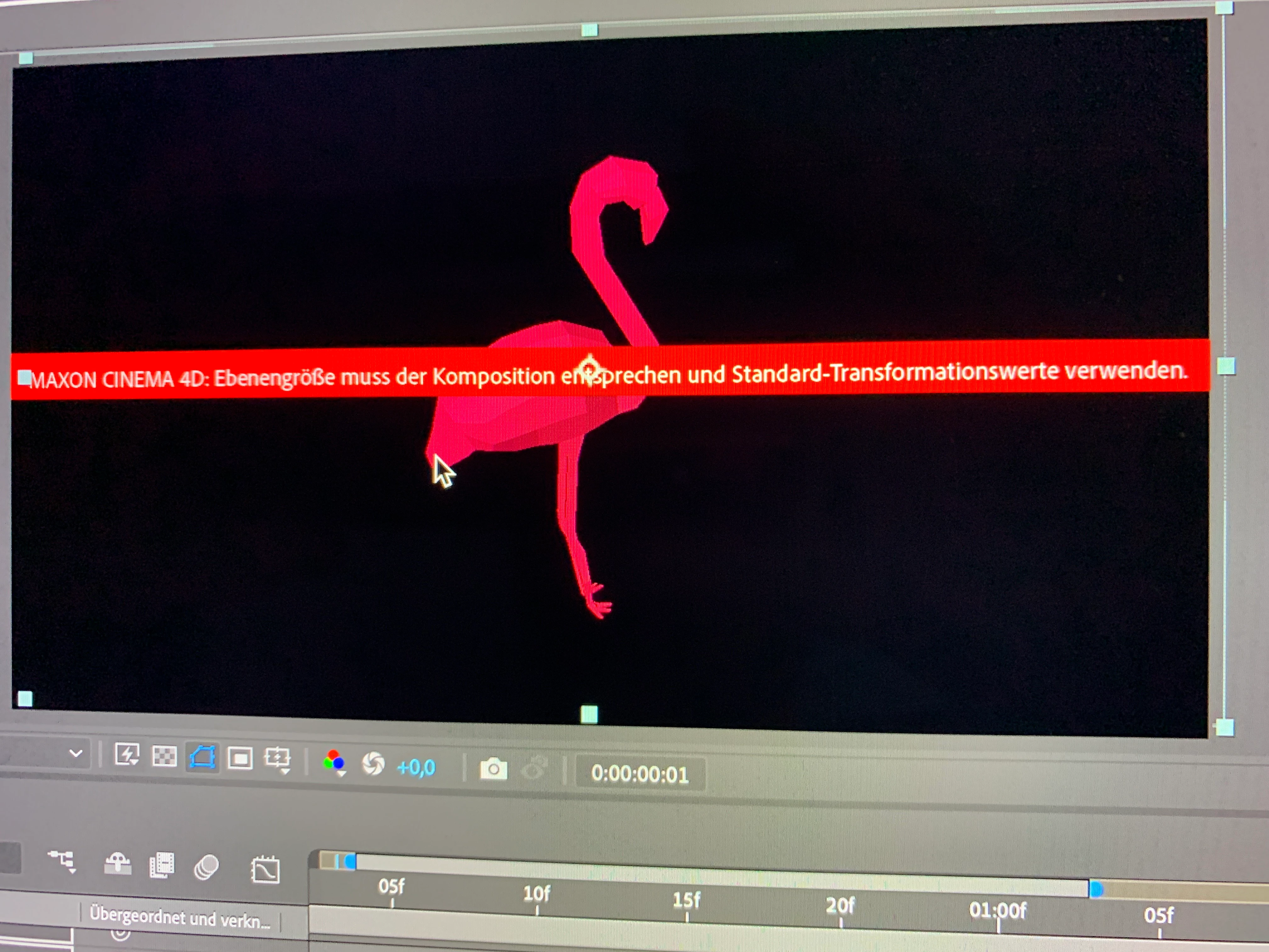

Hello friends,
i want to to import my jsx script in after effects wich i can do but i only have the plain then but not the solids. so i cant see my object that i did in blender in AE. can anybody help?

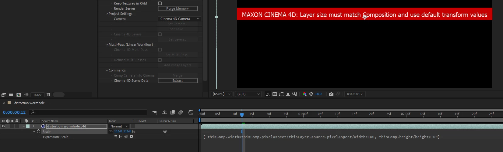

ShiveringCactus
August 6, 2021
Check the C4D layer's scale property in the composition.  It should be fixed to 100%, but if the expression has been disabled somehow, then AE cannot resolve the mismatch and brings up the warning, like this:
That's me taking at guess at the german translation, but I think it's the same message.
Mylenium
August 5, 2021
Nein, natürlich sollte es einfach klappen ohne sich den Arm auszurenken. Vielleicht kannst du ja einfach mal ein paar Screenshots von den C4D Render- und Szenen-Einstellungen machen. Möglicherweise hängt's an irgendeinem dummen kleinen Häkchen, das irgendwo falsch gestellt ist.

Mylenium
August 4, 2021
Steht eigentlich alles da, wie's gemeint ist. Die Größe der Ebene mus der Kompositionsgröße entsprechen. Also mal in C4D die Szenen- und Rendereinstellungen checken und mit der Kompositionsgröße in AE abgleichen oder umgekehrt.

ifeellousy
August 4, 2021
Ja hab ich gemacht. habe in beiden Programmen Größen der Komposition bzw in C4D Rendergröße angepasst. aber wo finde ich die standard transformations werte?
Mylenium
August 4, 2021
AE does not import any kind of 3D geometry natively. It seems you have a misunderstanding there. Whatever script you are using is likely simply meant to align the scenes after which you have to use Cineware or Element 3D to import the actual objects and place them in the scene where the script has created placeholder Nulls and solids. You may wish to go back and re-read the instructions for exact procedures. anything more would require better info, anyway, like how your scen is set up, what you are exporting and importing and so on.

ifeellousy
August 4, 2021
i just managed to import my file into cinema 4 lite and create a .c4d file wich i can import into AE but to use my 3D object ther must be some setting. in the image below u can see what AE is telling me.. what does it mean? i have to change the settings in Cinema 4D ?
