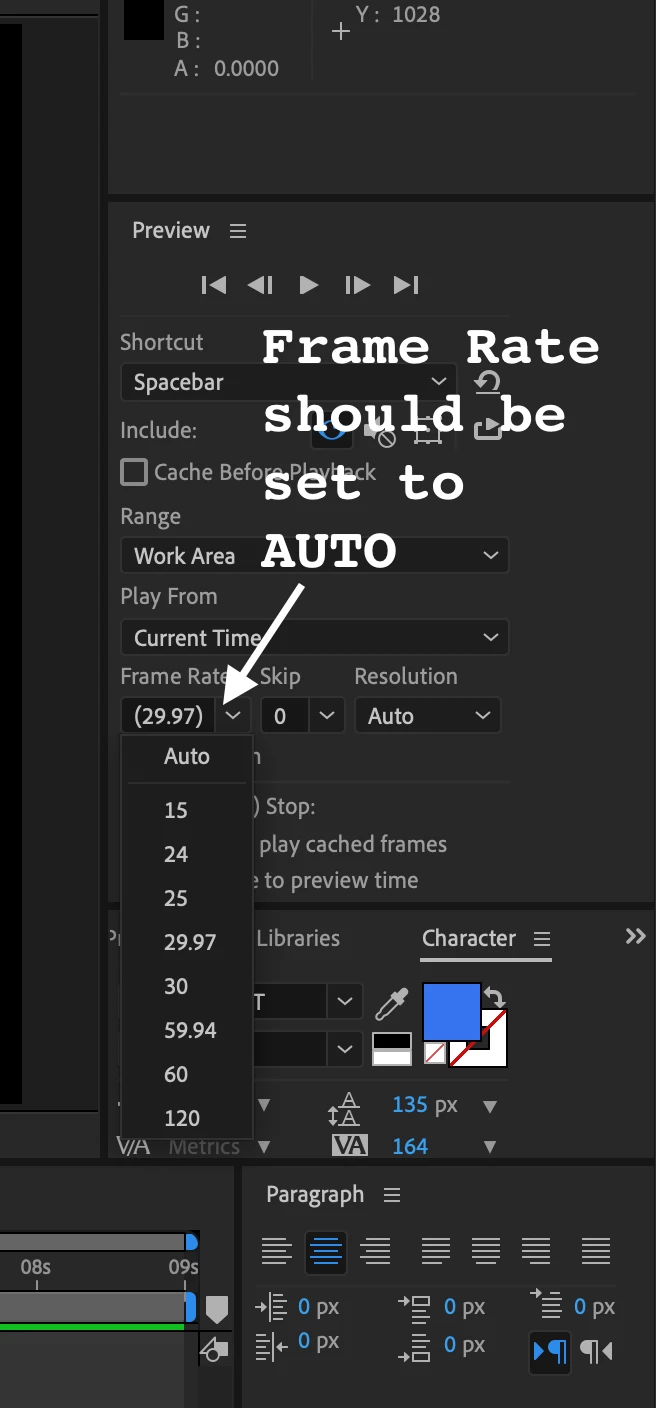

Correct answer Rick Gerard
You need to check the Preview Panel.
If the frame rate for playback is set to 59.94 and the comp is set to 12 then the playback will be more than 4 times normal speed. If it is set to 29.97 and the comp is set to 12 playback will be a little more than twice normal speed. On a very rare occasion I will lock my playback speed to a different frame rate but 99.95% of the time Auto is the correct setting. If you don't see () around the frame rate then you have locked in a specific playback frame rate.
That also explains why the file a friend sent plays back at the wrong speed. Sorry, I should have caught that.
Rick GerardCommunity ExpertCorrect answer
May 22, 2020
bburgessAuthor
May 22, 2020
This was the problem! Thank you so much!
