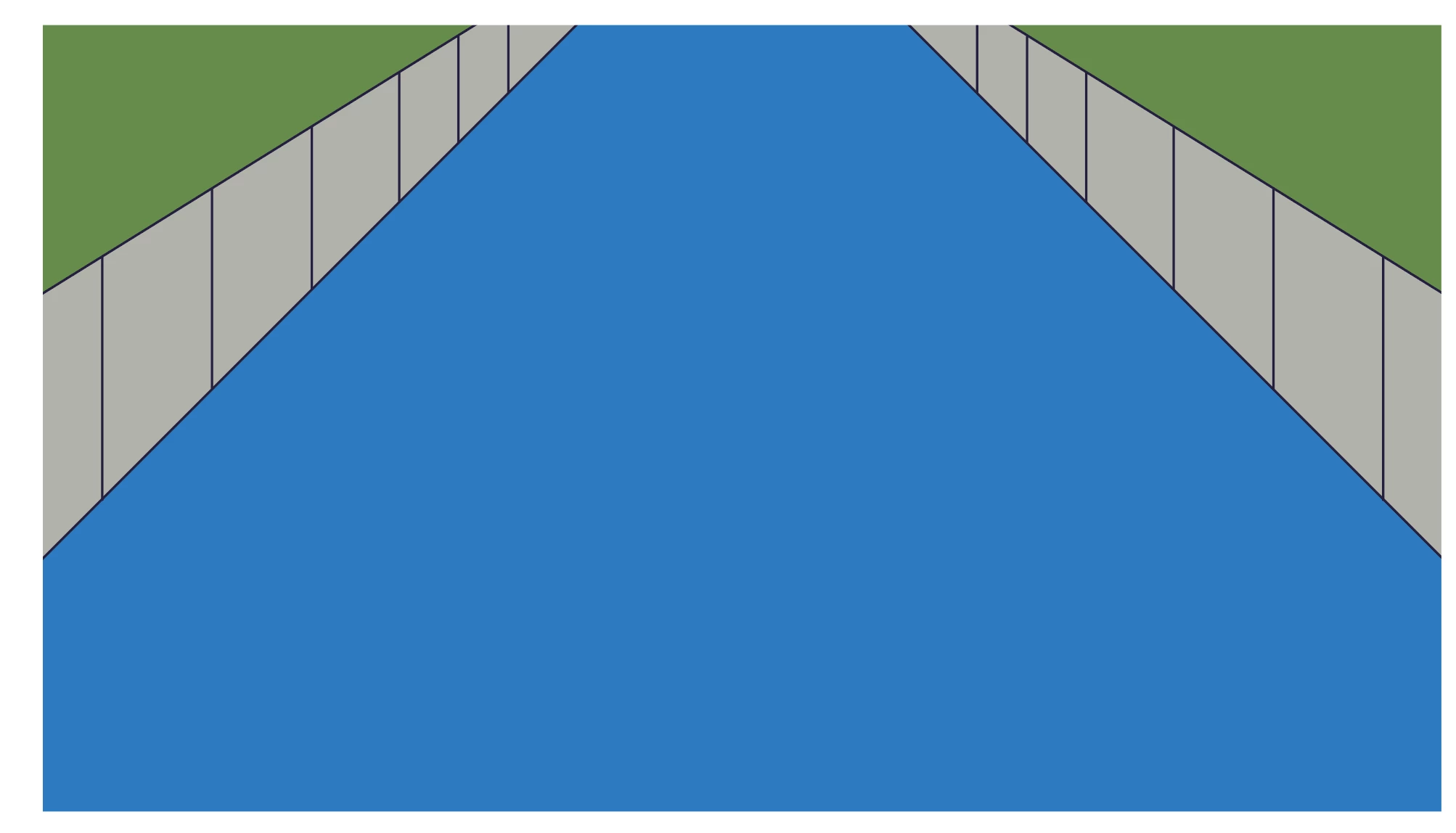

The thing is, I was trying to keep the stroke widths consistent as they go back in space. It fits the style of the illustration.
I managed a workaround by scaling down one line and using an expression to keep the stroke width consistent (and then repeating it) . Here's the rough result.

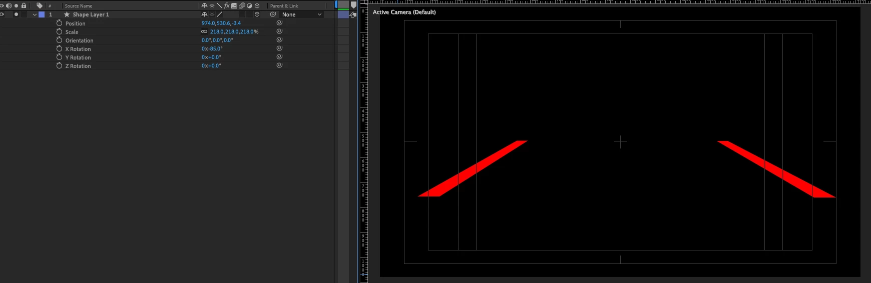

You can use the Taper function on stroked paths to simulate an object receding into the distance.
But, depending on what you're trying to achieve, it might make a lot more sense to build your environment in 3D, rather than simulate it.  Here's two straight stroked paths, rotated in 3D so that they naturally recede into the distance.  Working in real 3D space will give you much more opportunity to interact with other elements in 3D space, plus the ability to light, add depth of field etc.
