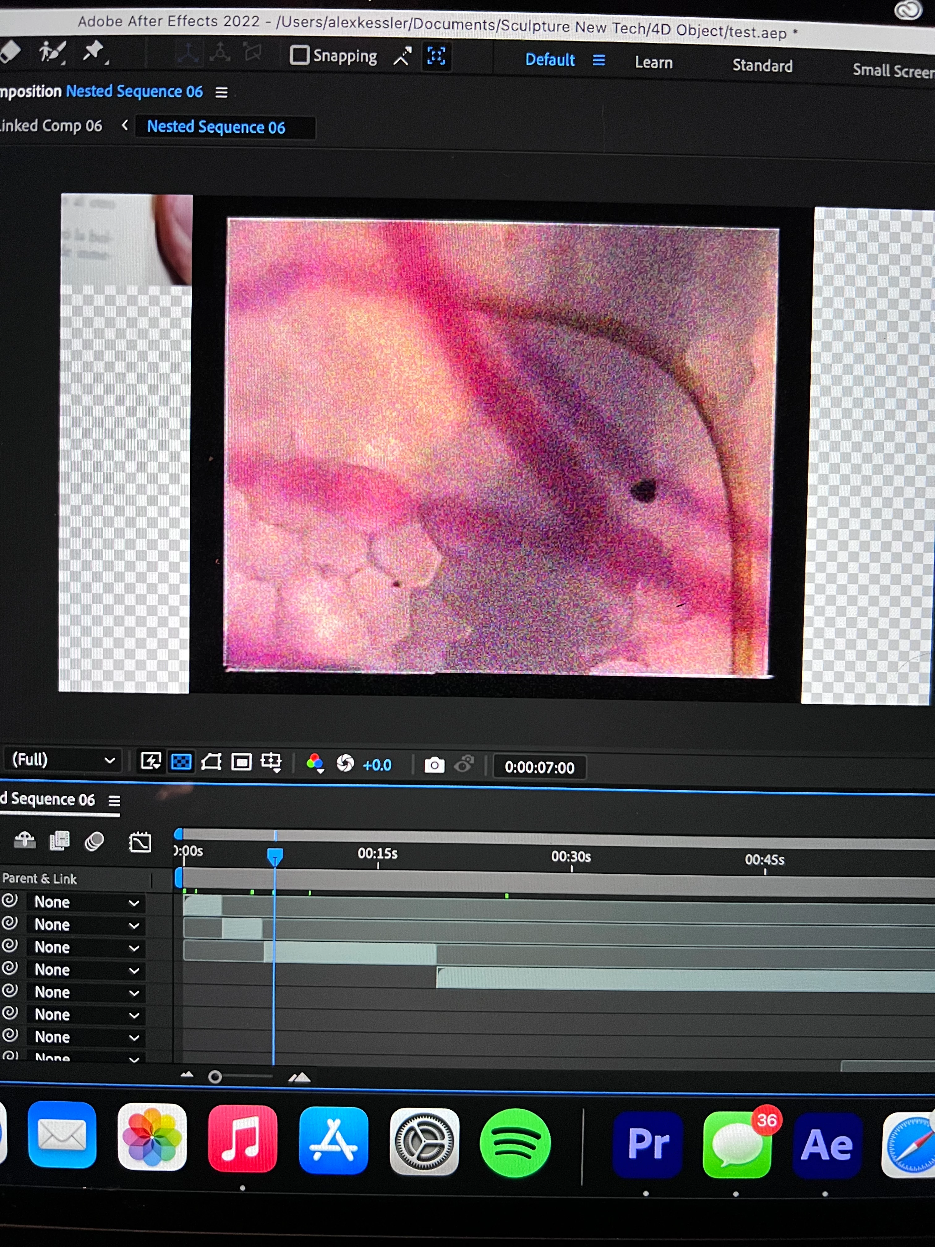

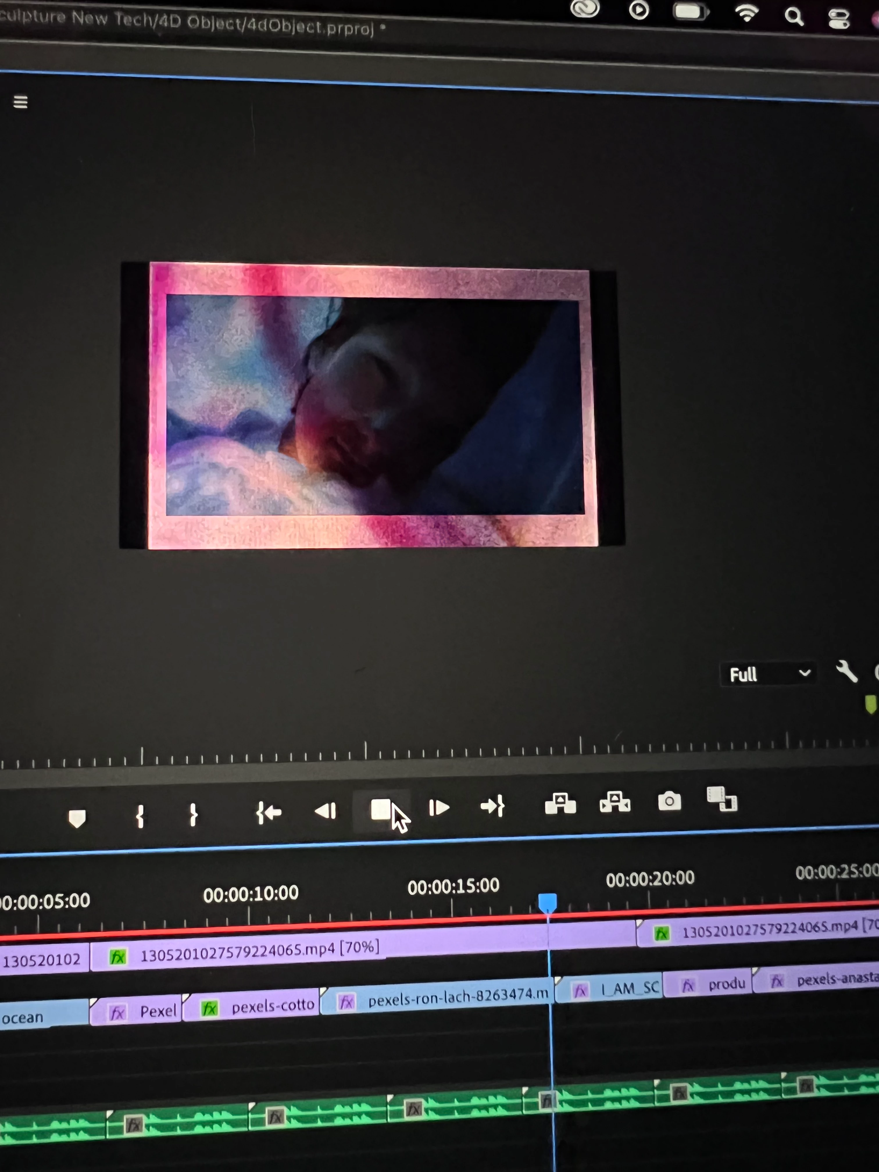

i’m trying to follow a Youtube tutorial to create a “pulse/heartbeat” effect in After Effects. my video is somewhat complex and has multiple clips stacked with varying opacities. when I’m in premiere and try to replace it with an After Effects composition, my entire clips becomes wonky and not displaying properly. any ideas/advice?
I attached what the premiere video looks like in premiere (what it should look like) as well as how it appears in After Effects.

sunsereina
February 16, 2022
No luck with nesting. Here's what it should look like:
sunsereina
February 16, 2022
but instead, here's how it turns out in After Effects. no luck with nesting - same result.
