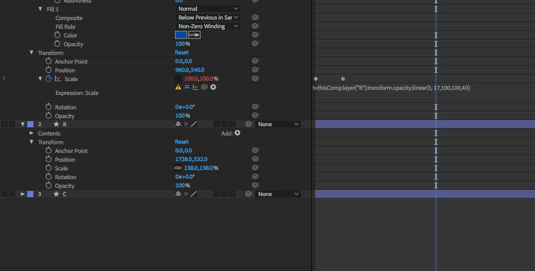

I have it like this. Scale drives opacity - still get an error.

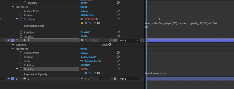

Just use:
t=linear(thisComp.layer('B').transform.opacity,17,100,40,100);
[t,t]
September 25, 2018
Thanks like this?
September 25, 2018
On a second line. You are defining a variable called 't', then passing two copies of it to the controller.
September 25, 2018
Hi Thanks
Not working - get an error - expression must be a dimension 2 not 1
This is my testing Comp -
I have added Linear expression to Scale layer A then linked it to opacity Layer B. Layer A scales from 17% to 100 percent. Layer B should fade out from 100 to 40 at the same time. Thanks for your help. Mike
September 25, 2018
Scale needs two values for horizontal and vertical, so end your expression with [t,t]
