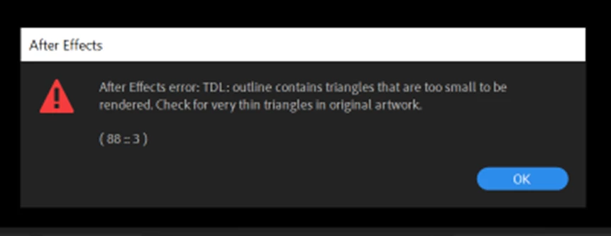

I  keep getting this error when trying to do a 3d render of this Coat of Arms...
Can somebody please explain and let me know of a fix or workaround because this error is holding me back on a project I was asked to complete a few weeks back.
Thank you

And your Coat of Arms is made with Shape Layers? with Masks on solids? with Illustrator? Show with screenshots to have a better overview and you should offer a little more information that you consider important.

Without seeing your artwork and having system info at hand nobody can tell you much, but typically it means what it says - your geometry is not clean which could be anything from simply too many tiny paths to said paths being open or having duplicate anchor points to invalid self-intersections. With that in mind I'm pretty sure the answer is not pushing a button or tweaking a setting but rather investing the time to clean up your artwork. Anyway, more info is required for a definitive assessment of the situation.

Also, what I am working with is not text but an image of a Coat-of-Arms for a country.
