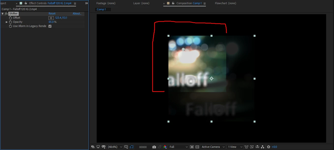

Using SmartFX and expanding on the 'Shifter' Example project, how can I expand the bounds of my square layer here to show the shifted image on top in its entirely, rather than being restricted to the original square?  
I know it is something to do with the extra and/or PF_CheckoutResult but cannot pinpoint how by messing with the result_rects!

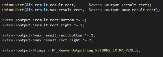

@James Whiffin Which rects are we talking about, the extra or the input? I have tried on the extra and the input in various places in the PreRender(), but I get 'AEGP Magic Error'. Is this the right format?
