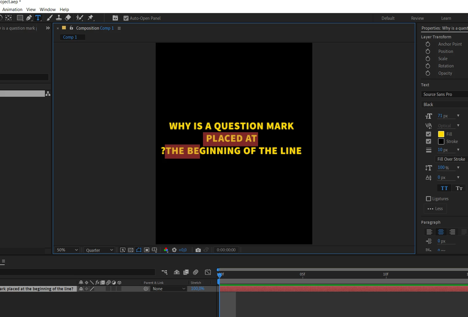

When I enter text everything is fine. But as soon as I get to the punctuation marks they are immediately put at the beginning of the line. Something very uncontrollable happens.
Help me figure this out.
This all started happening after update 23.5 of 02.07.23

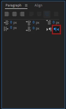

Correct answer Ali Jaber
Usually, this happens if you choose right to left text direction in the paragraph panel, in this case, switch to left to right text direction
Ali JaberCommunity ExpertCorrect answer
July 4, 2023
July 8, 2023
It worked! Thank you so much.
