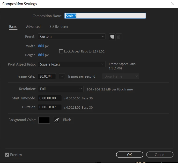

Somewhat recently (within the last 2 months, I think?) I've noticed that on my timeline in AE, if I position the playback indicator on, for example, the 10 second mark, it isn't actually on that tick mark, it's about 3/4ths of the way from the 29th frame mark before it. Towards the beginning of the timeline it's accurate, but as the timeline progresses it becomes more offset. It's like this for every frame/second marker, and results in the end of my timeline being off by a second or two, so I have to overextend my composition length in order to access the desired end frame (for an 18 second animation I need the composition time to be 18:02 to be able to see 18:00).
I'd almost think it's just my framerate, but if that were the case I should still be able to position my playback indicator accurately as I have in the past, I would think. Unless there is a setting I changed mistakenly, or just something I'm unaware of?

That's a very unusual set of frames per second you have there. Try making it just 30.

What kind of framerate is 30.0194? It is not a standard one, adjust that parameter well.

Here's my composition settings!

Check your project timebase settings, your comp settings and your footage interpretation. The behavior would be indicative of a framerate mismatch or using drop frames or pulldown somewhere.

Are you working with a 29.97 fps composition? Please upload the screenshot that Szalam requested.

Can we see a screenshot of your composition settings?
