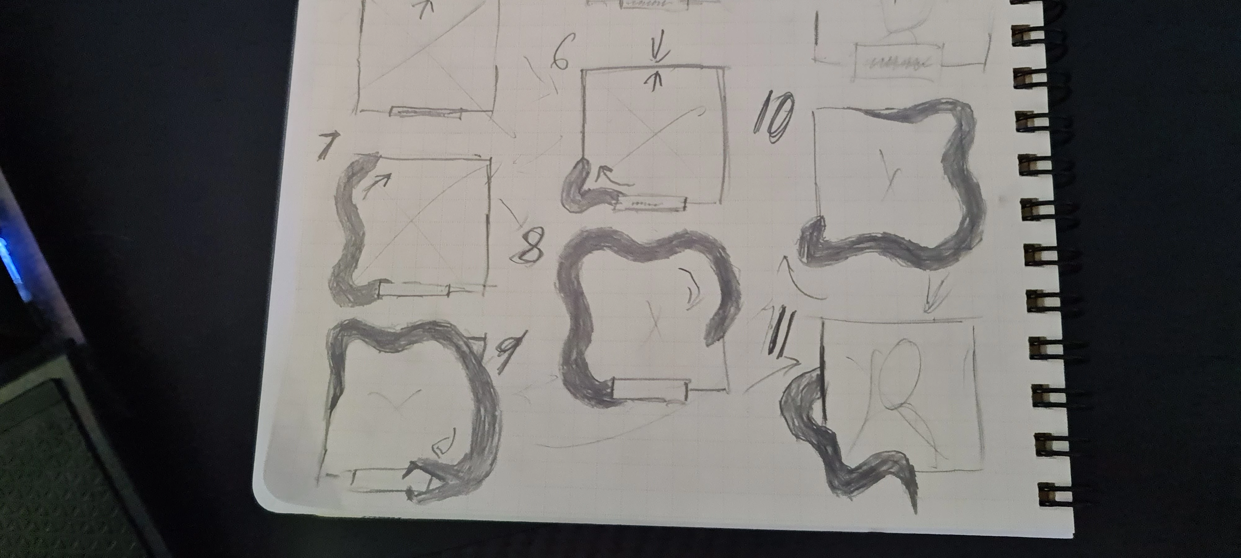

below is the sketch I did when I conceptualized this if you have a tough idea visualizing what the slithering snake was like (the parts where it eats an element and then goes behind the frame can be ignored).

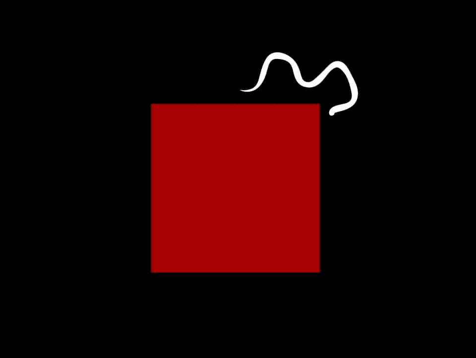

Nearly! When snakes move in the real life, their tail won't follow through the same point the head did, but will have slided a bit as they push off the surface they're on. That's what the quick and dirty demo shows below.
This is the whole reason why I'm struggling for several of these solutions, though it's not the only issue. I need Path Info for Trim Paths and I need some way of affecting that path in to a Sine wave so that it can offset 😕😕

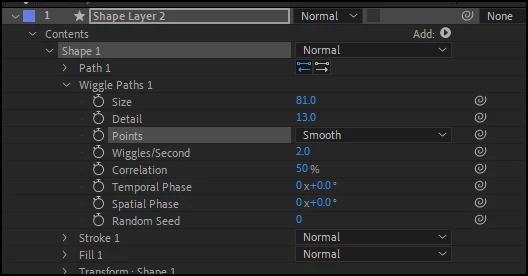

Have you tried using Wiggle Path on a Shape Layer's path?   If you add sufficient points and set the Points to Smooth, I think that's what you're describing.

Unfortuantely it's completely random, I can see it working wonders in other projects, but not this one. A sine (or cosine obviously) is basically whats needed.
