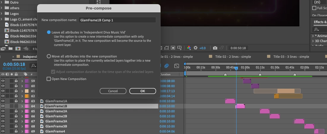

Scenario: Unsure which of these to select, cannot risk messing up this project.
Question: What is the Difference Between these 2 Precomp Options?
Fig. 1: PreComp Options

Leave All attributes keeps all effects and animation in the main comp. The pre-comp only contains the original layer, it has no effects applied, it has no animation. Leave all attributes also is only available if you select a single layer. The new comp is the same size and frame rate as the footage, which may or may not be the same as the main (original) comp.
The second option, Move All Attributes, moves the layer or multiple layers into a new composition and all of the animation and effects are preserved. The new nested composition (that is what you get when you pre-compose, a comp nested in your original comp) can either be the length of the selected layers or the length of the original main comp. I usually use Trim Comp to layers.
It sounds like you want to replace a footage layer with different source footage and preserve all of the animation and effects you have applied to that layer. The cleanest way to do that is to select the layer you want to switch in the Main comp, then select the new source file (new movie) in the Project panel and then hold down the Alt/Option key and drag the replacement footage to the timeline. Everything that was modified on the original layer will remain, only the source will change. You can only do this with a single layer.
If you pre-compose leaving all attributes you will have to open the pre-comp and then drag the new source file into the timeline and delete or turn off the original layer. Sometimes this could be more efficient, but most of the time I just use the Alt/Option + Drag workflow to replace the footage.

"Leave All Attributes In
Leaves the properties and keyframes of the precomposed layer in the original composition, applied to the new layer that represents the precomposition. The frame size of the new composition is the same as the size of the selected layer. This option is not available when you select more than one layer, a text layer, or a shape layer.
Move All Attributes Into The New Composition
Moves the properties and keyframes of the precomposed layers one level further from the root composition in the composition hierarchy. When you use this option, changes you applied to the properties of the layers remain with the individual layers within the precomposition. The frame size of the new composition is the same as the frame size of the original composition."
Going to experiment with which one is right for this project, just wish it was a bit clearer.
