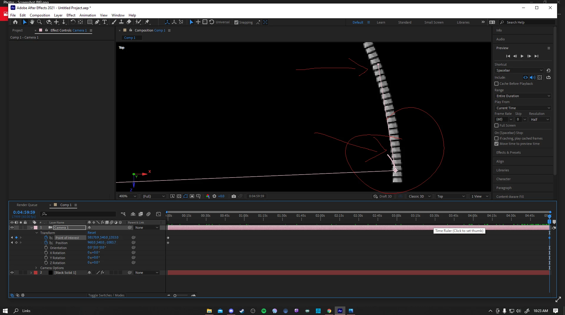

Hi all, I am very new to after effects. I am not taking a class mainly watching you tube videos and reading tutorials. I have Adobe After Effect CC 2021 and in this picture I am trying to make a camera follow the arch. As you can see I have the Point of Interest brought to the end of the arch. now here is my issue. you can see the horizontal line that is the focus line for the camera as the camera is still at the start of the arch. The vertical line is the adjustment line that I drag to adjust the angle and allow for an arch. the middle slightly curved line is the line I am adjusting. It used to show up as a whole line across the entire project now it is this little tiny thing and I cannot figure out what I did to make it this way. I need to see the whole line so I can make the adjustments accurately. Again I know this is a level 1 or even level 0 question. I am just not finding what I am looking for to help me.

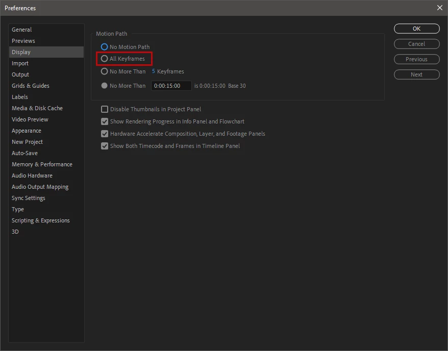

If I understand correctly, you want to see the motion path of your entire animation, and you only see a part of it.
If this is the case, here is the solution: your animation is 5 minutes long, After effects by default displays the motion path for 15 seconds from your current time indicator and you can change this by going to edit > preferences > Display:
In that dialogue box choose "All Keyframes". This way all the motion path of your animation will be displayed

This was the issue. THank you so much for the help.
