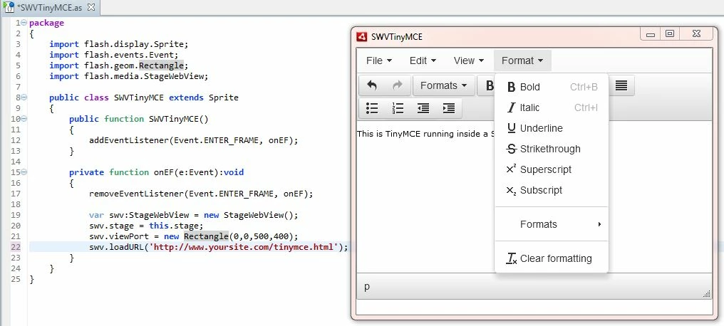

I would initially assume it's not working because TinyMCE may think it's running from the wrong path. The same way you must configure most of those editors to know "relatively" where its files are, TinyMCE may simply not be able to find its libraries. For example if you're using an invalid relative include like <script type="text/javascript" src="<your installation path>/tinymce/tinymce.min.js"></script> where <your installation path> is incorrect.
A quick way to find out is simply point to the script with a full address, http://www.yoursite.com/<your installation path/tinymce/tinymce.min.js

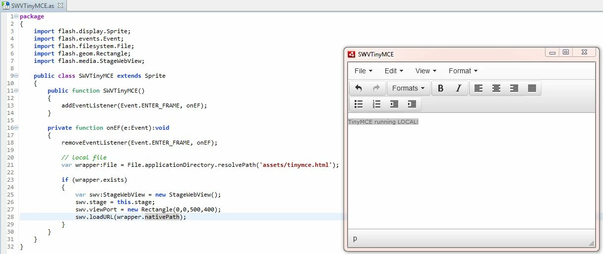

Just tried it quick, works for me:
And running local using File (with a wrapper HTML):

sinious
December 17, 2013
You're welcome and for the others sake perhaps you'd like to share your findings. Was it simply addressing files with the File class in AIR or was it using Pedro's SWVB class?
