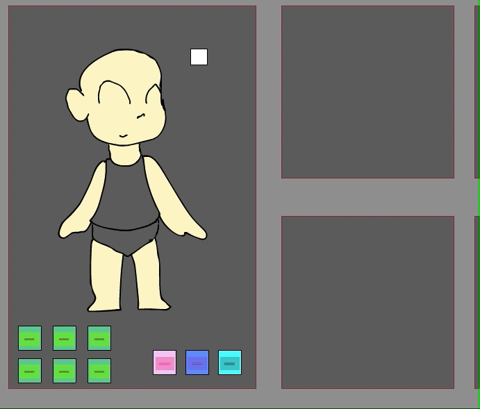

Well... the idea of kglad's of putting the movie clip name in the brackets removed all loading errors to make it playable, however... when I loaded the game and clicked the display character button to reveal the frame where the color picker code is, I got a bit of a glitch... its rather hard to describe so I recorded it:
(mild flashing warning)
I am genuinely unsure what steps to take next, I want to be able to change the color completely, If anyone has a complete alternate code and instructions link I could sure use it... Otherwise I'll keep working around this code...
