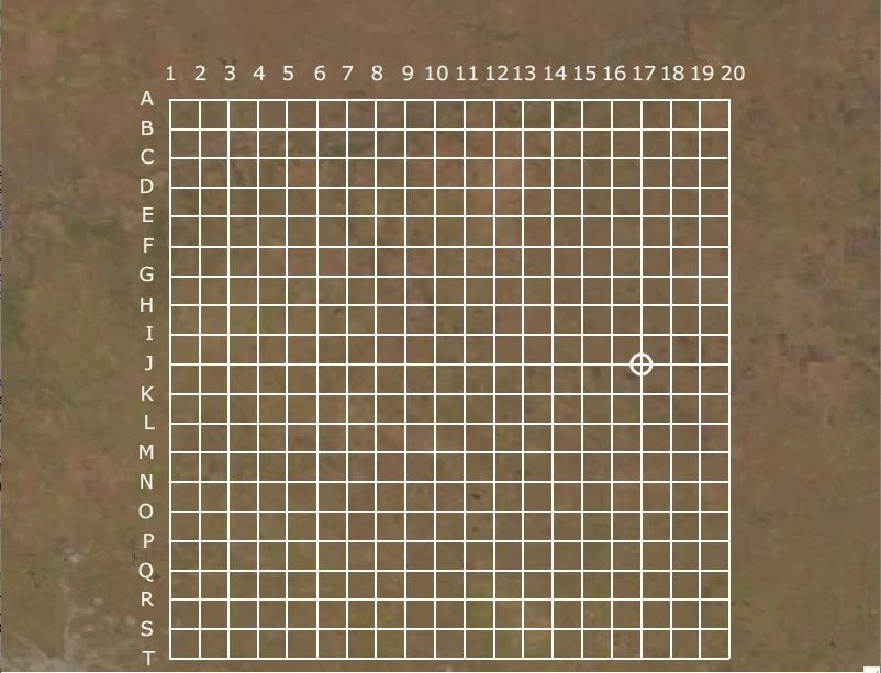

I've created a 20 x 20 grid of objects (openCircles). They're set to 'alpha = 0', then 'alpha = 100' on rollover. This works for all of them except for the final one at the coordinate T,20 in the bottom right corner, as I'm not able to rollover over it. To test whether or not they all existed, I set them all to an initial value of 'alpha = 100' and they did all appear, but I'm still unable to rollover the one at T20.
The other problem is that when an 'openCircle' is clicked, a 'filledCircle' (set up as another grid of invisible objects in the same place) is supposed to appear in its place. That doesn't happen. All of the objects are created and exist, using attachMovie, so it's maybe due to some logical error. See code:-
I'd be grateful for any help. Many thanks.

This is an image of the grid showing an 'openCircle' visible when rolled over
