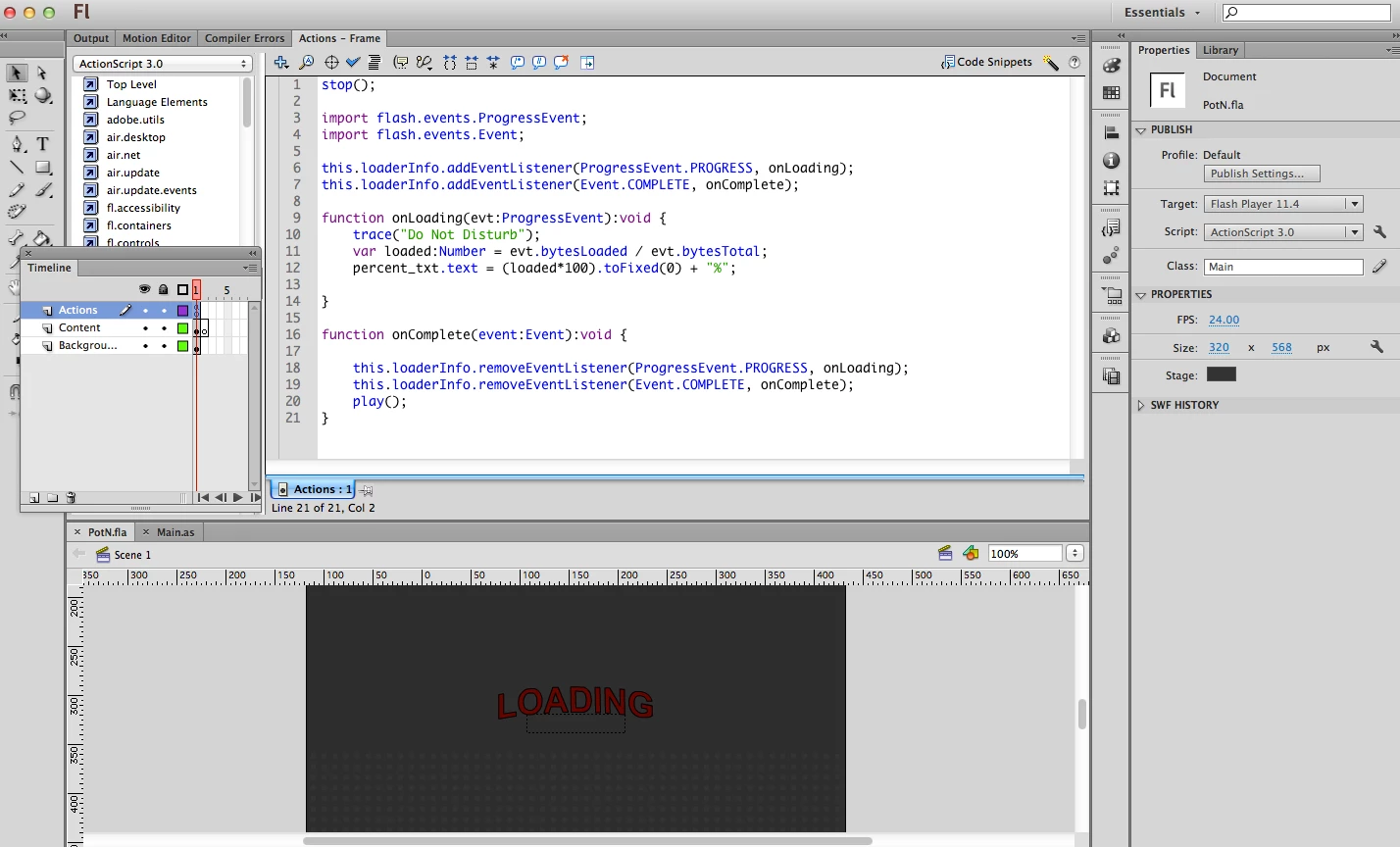

Alright well I've been trying for days now to put a preloader in my code.  Right now, this is what I am trying:
This is the preloader template that adobe gives you.  I have it in frame one on three layers.
stop();
import flash.events.ProgressEvent;
import flash.events.Event;
this.loaderInfo.addEventListener(ProgressEvent.PROGRESS, onLoading);
this.loaderInfo.addEventListener(Event.COMPLETE, onComplete);

Correct answer Amy Blankenship
Thank you very much kglad, that code makes a lot of sense to me and is straightforward.  However, it still isn't working.
Here is the Action Script, stage, and timeline for PotN.fla

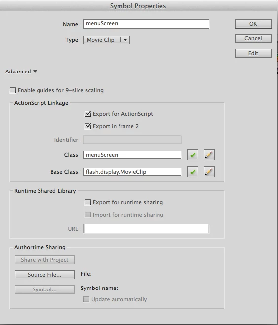

Here is the menuScreen properties which are identical to the play_Button properties:

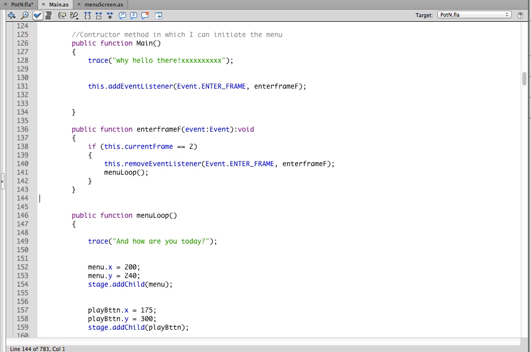

Here is the new code of Main.as, my Document Class:

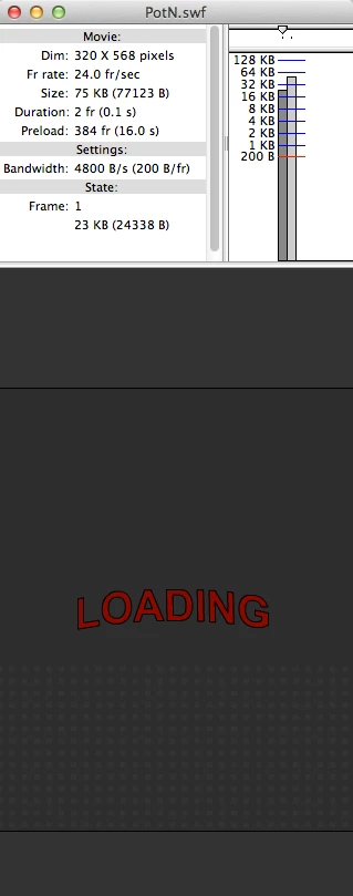

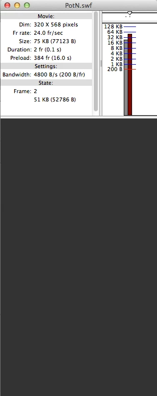

Here is what I believe is a size report, showing what's happening on frame 1 and 2 respectively:

So, when you define playBtn=new play_button;
This has to run before the constructor. As do all your other statements where you're defining new someLibraryObject(). Therefore, by the time the code even gets to your preloader, you have one of two situations (I'm not sure which, because I code on the timeline, in large part to amortize compilation of the library symbols throughout the swf, reducing the need to even have a preloader):
  1. Your Main Class can't create the assets at the time you tell it to, because they're not compiled in yet. or
  2. They get compiled in because you're referencing them in Frame 1, but because you've forced so much stuff to have to be loaded prior to frame 1, by the time you even see the loader screen, the movie is already loaded.
MPO is that it is probably #1 based on the symptoms you report.
So let's try this:
  1. Delete "Main" out of the Document Class field.
  2. Create a new MC in your library and set Main as its Base Class.
  3. Place an instance of it in Frame 2.
  4. You can continue with the overly complicated logic you already have, or you could go with the simple/elegant solution of just allowing the playhead to stop at the compiler frame and play into Frame 2, where you can put a stop() frame script.
  5. Go back to calling your mainLoop() directly from the constructor of Main.
