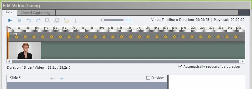

I have a 25 second video on my timeline, yet there it shows as being 38.2s, and I cannot drag the trailing edge to shorten it.

    Hmmm, wondering if the 25 second video is using a different frame rate?
    I know Captivate typically assumes 30 frames per second.

    You guys are wonderful. The video is 25fps. I would imagine that changing my project to 25fps will screw up all of my timings, possibly even my closed-captions. Luckily, I'm at the early stage of the project.

    What is the framerate of the video? Default framerate for Captivate is 30fps.
    How does it look when you play it in the editor?
