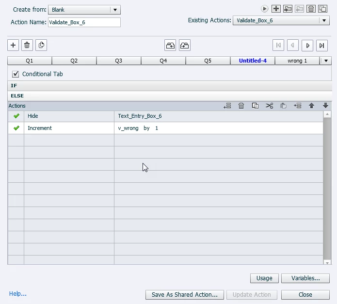

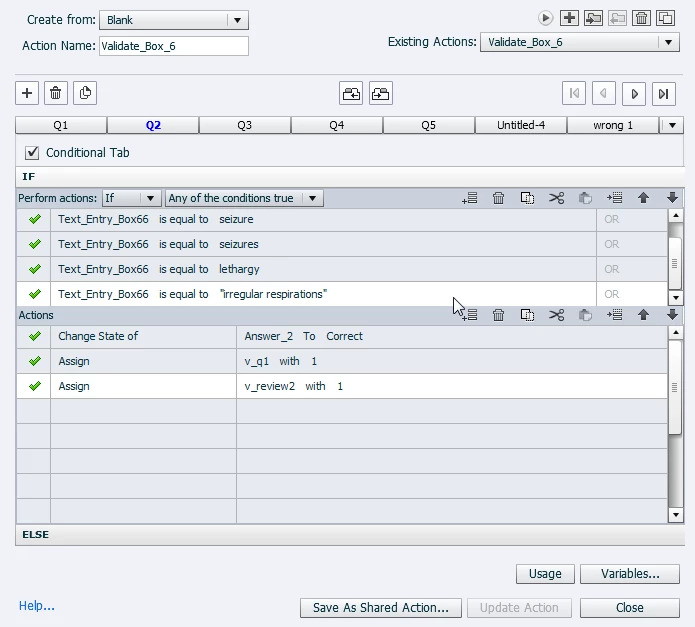

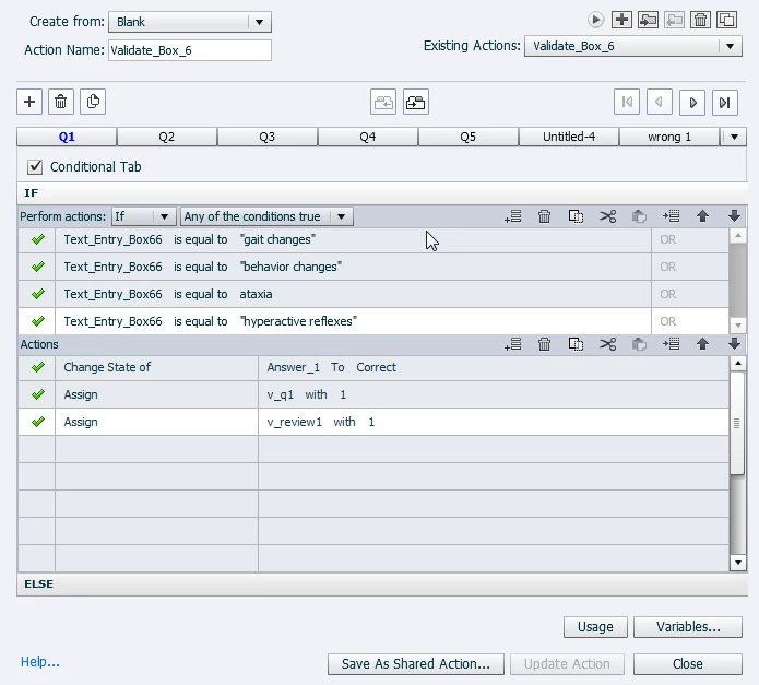

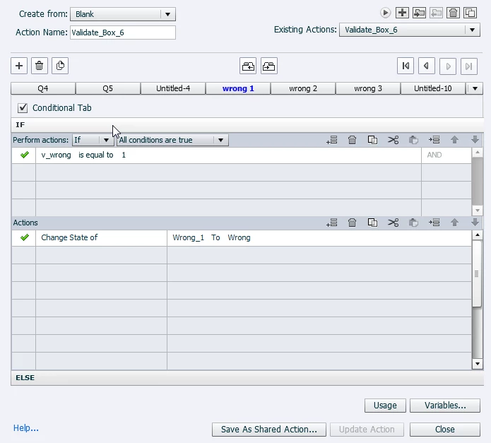

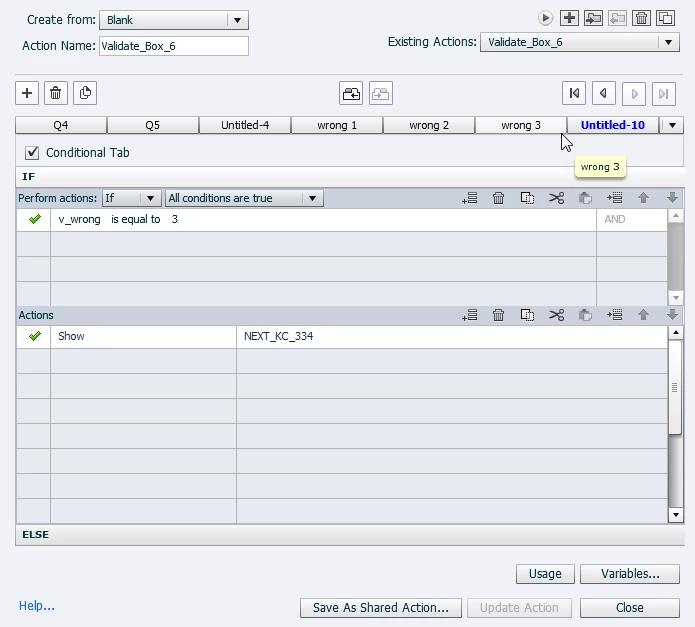

    There are 5 text entry boxes, each one has a separate variable associated to it. They are on top of one another and once one is used, it is set to hide, so on so forth (2 are below so you get the idea). The review variable is how I track "duplicates" - on additional boxes and also how I have it set for incorrect feedback. If they miss 2 out of 3 answers, then they see a "review button" and that button takes them to the next screen to show correct ones in one color and the ones they missed in another.
    This is the If/Else so if they get any of the answers or none of the answers:
    I have it set to they get 5 attempts, but can only make 3 mistakes including providing duplicate answers
    Again... this isn't all of it, just a snapshot to give an idea. If something stands out feel free to let me know.
