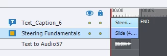

I would ask how your audio looks on the timeline?
Do you have a buffer of space, say 1 -2 seconds, at each end of the audio clip?
Without this buffer, Cp can try to build all course audio as a single export file.
In some cases, like yours, audio for a single slide will be omitted until the audio timing for each slide is adjusted.
So, just changing the timing of the audio for your one quiz question may not be enough.
Save a copy, edit the timing for multiple slides, including the problem question, and republish.

I was already doing this on every slide to avoid the audio playing too quickly between each slide. I also recreated this separately with and without this spacing to test and with both KC and quiz questions slides. I did get through to Adobe support (chat) and they did identify it as a probably bug.
I am going to try adding a fake KC slide in the 3rd slot and try to get it to pass through without clicking and see if that works. Possibly add a moment of silent audio if needed?
