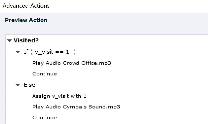

    I that case I would use the Play Audio command, not slide audio (which is necessary for CC). Still, I strongly recommend to use custom navigation. At this moment, there is a bug for HTML5 output in CP2017, where the On Enter action is not executed when coming back to a slide. I hope it will be fixed soon in a patch. You will need an advanced (or shared action) like this to be triggered by the On Enter event of that slide, and a variable that will track if it is a first visit. Here are the steps:
    1. Create a user variable v_visit with a default value of 0
    2. Create an advanced action like this:
    3. Attach this action to the On Enter event of the menu slide
