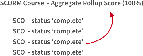

skeathlyAuthor
February 22, 2016
Wish I had a SCORM file that I could take a look at to see how that would work.
Seems like I'm trying to do something pretty basic, but it is turning out to be pretty difficult since there are not good examples on how to implement.
Just trying to get course score based on the completion of individual SCOs (below).
