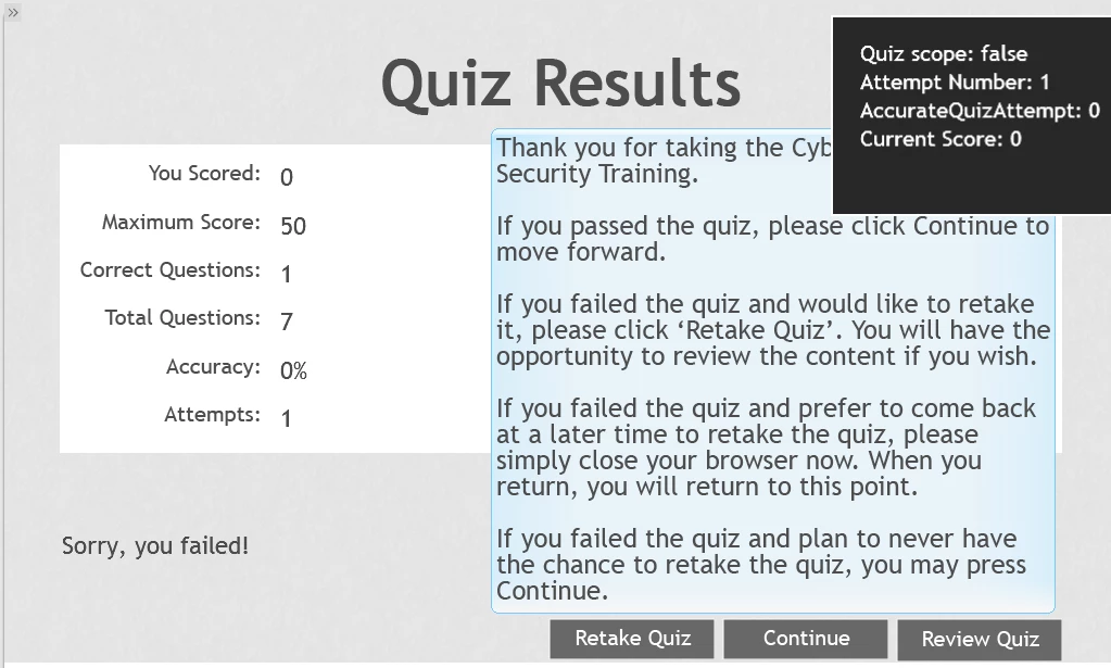

If I skip the pre-test is shows below in my tracker
After I answer all of the post-test questions correctly, it shows below.
There are some advanced functions to skip the quiz, # of attempts, etc, but they all appear correct. Thanks.

OK, so you didnt use the Pretest questions, which makes your title bit confusing.
Did you check the Advanced Interaction panel (F9)? I should have to screen all advanced actions, which looks bit beyond the scope of this forum.
To debug: please insert some quizzing system variables on the first slide, timed for the rest of the project to watch their value. I think about cpInfoPercentage, cpQuizInfoPointsscored, cpQuizInfoLastSlidePointScored.
