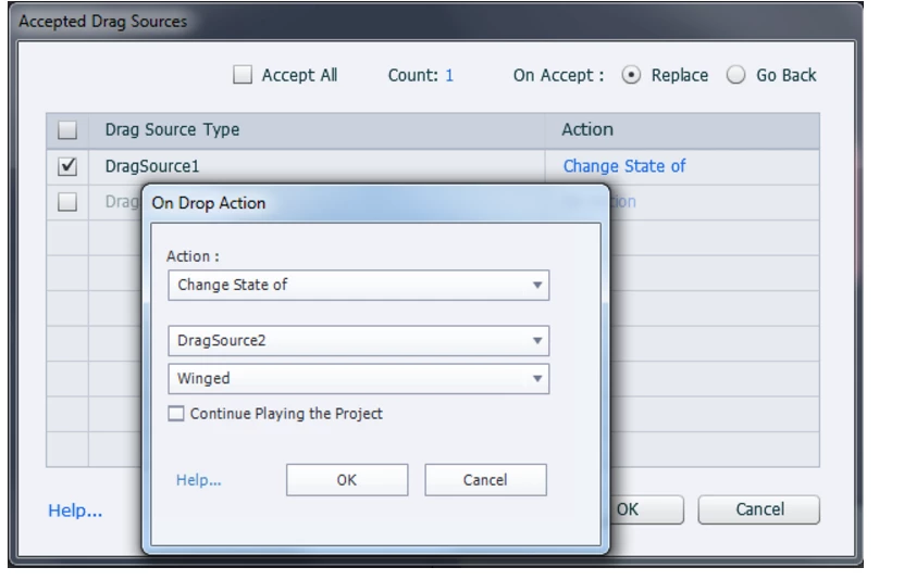

    As it seems in my Captivate Version the inbuilt states DropCorrect and DropIncorrect are missing.
    Is this because I'm working on a Trial Version?
    Thanks for your help.
    Greeting
    March 1, 2017
    You need to set up advanced actions on accept. See the step in Lilybiri's post. You have to create the states using state view and then use the action to Change state or create an advanced action if you want to do more than just change the state view.
