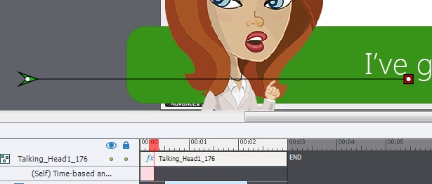

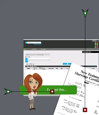

I'm using Captivate 9. the effect I'm using is a standard Entrance effect, and it seems to be stopping on the second to last frame. I've got this effect in my project multiple times and it does it on every single one of them.
There are no pause moments. It's triggered by the start of the slide and finishes before the slide ends.
Example 1:
Example 2:
There are no pause icons on any of the items in the timeline. Plus the second animation (the marriage cert) starts after the talking head slides on.
Neither the talking head nor the marriage cert end where they're supposed to.
