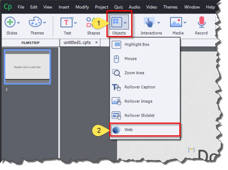

Perhaps save this HTML page in the same folder and use the Web Object in Captivate to load it?
Cheers... Rick
February 4, 2016
It is saved in the same folder. What web object is it that you speak of? How do i get there?
Captiv8r
February 4, 2016
Hi there
Clicking the Objects (in the Big Button Bar) followed by Web?
Cheers... Rick
