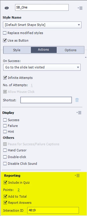

       Is there a way to put a Captivate variable in for the points that are returned rather than hardcore it in the Reporting section?

    I am speaking about the screen shot above. In the reporting section there is a points field. You can specify a number, but there seems to be no way to put a variable in for that argument.

    Set the button to report to the quiz by selecting that option in Actions > Reporting.  When you select this option, it allows you to assign the score value which will be reported.

       Thanks for the quick reply. I have created a smart shape button, but do not see a Reporting in the button Actions. I looked in the advanced actions and do not see it there either. Where should I look for this Reporting option.

    Did you define the shape as a button? If yes, reporting is in the Actions tab, last part:
    Another tip: you have a nice overview or all scored objects and their status in the Advanced Interaction panel (F9).
