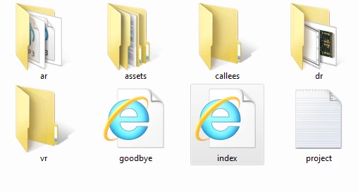

    Thanks for responding.  The issue is that sometimes it will preview in IE, sometimes it won't.  When it doesn't, I have to reach out for Tech support so that they can make some admin related adjustments.  The index.htm file that I open independently is an IE file in the "My Captivate Projects" folder (see image below).  In most cases this file will open, but I have to publish the entire file in order to preview it.

    I never publish until the end, but have full control over my system of course. I wonder if you run Captivate as Administrator, which is required to have its full functionality.
