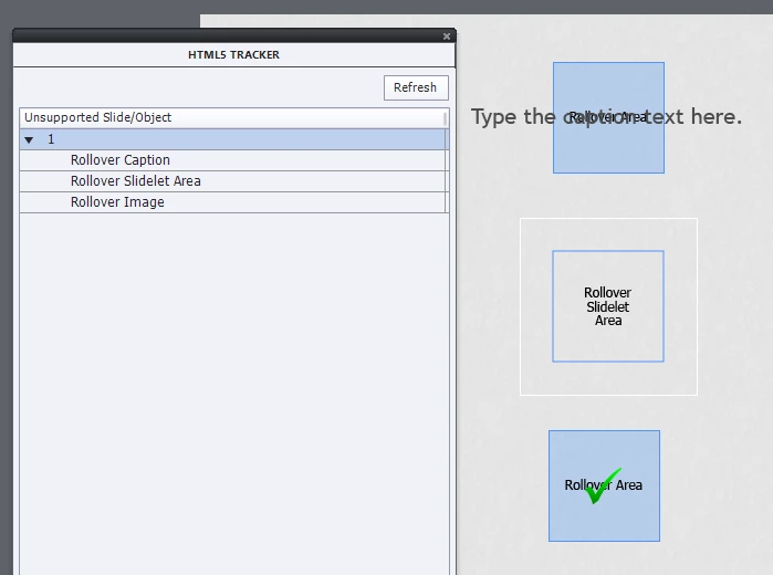

My company currently publishes projects as SWF, but this fall we're moving to publishing HTML5. I'm trying to do some research on what's unsupported in HTML5 and found a list of items at Adobe.com (such as text and SWF animations, slide transitions, rollovers, etc.).
To test it out, I put together a quick module. It includes rollovers, text animation (typing effect), mouse animation, etc. The HTML5 tracker warned me that rollover captions, rollover images, and rollover slidelets were not HTML5 compatible. However, when I published to HTML5 and viewed it in IE11, almost everything worked, including all the rollovers. I'm confused, because everything I've read points to the fact that rollovers will not work in HTML5 but they seemed to work for me. Am I missing something?
I should point out that we're not publishing responsive projects. Our entire target audience is using desktop computers and viewing the modules in IE11. Wondering if there's a bug in the tracker, or if its warnings only apply to responsive projects?

So far the only element I've found that is truly not HTML5 compatible is slide transitions. I'm sure there are more, but it doesn't seem to be as many as Captivate's HTML5 tracker says.
Rollovers are not compatible with most mobile devices, that is the reason the HTML tracker will report them for HTML output.
What is certainly not working are Text animations and SWF animations. For Text animations only a static image will be shown. FLV video cannot be played in HTML output, will be converted to MP4.  H264 (MP4) codec doesn't support transparent background, which is possible in FLV. Some issues can occur with PPT-imported slides and with FMR slides, but that is not always the case. The Effects that are classified as 'Other effects' in CP9 are not totally supported neither. Another difference I'm aware of: in SWF output an interactive object covered by a non-interactive object remains active, which is not (always) the case in HTML output.  Lot depends also on the used browser, HTML5 support is not the same by all browsers.
As long as you are mainly publishing for desktop/laptop keep to SWF when possible or publish for multiple screens. Experience by user is much more consistent with SWF output. At least as browsers continue to embed Flash Player. At this moment the interactive PDF published by Captivate needs Flash player, as does the EXE format.

The rollover captions, rollover images, and rollover slidelets are three specific items you can add to a project and are located under the Objects menu.
rollover
Rollovers, such as those for standard buttons or object states, aren't the same and should work in HTML5 output when viewed on a desktop.

My comment isn't off topic. Audrey said that she was getting a warning in the HTML5 Tracker referencing Rollover Captions, Rollover Slidelets, and Rollover Images, which are all items inserted via the Objects button.
Not really sure why you think I was referring to any Over, Down, and Up states for interactive objects.

I did exactly the same as yourself, published in HTML5 with some Rollovers.
Everything seems to work fine on Desktop computers running IE and a mouse.
However, when the content was accessed using a tablet computer the Rollovers did not work and I had to rethink my project design.
I only publish in HTML5 and avoid anything that CP9 tells me is not supported in HTML5.
