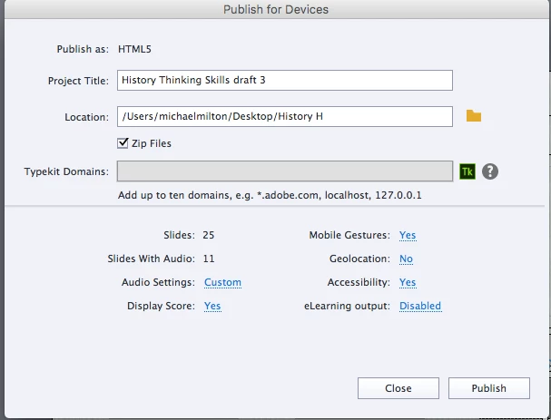

I am working on a project for a class in multimedia productions and I am putting together an Adobe Captivate responsive design program. I am running into issues of getting the project to be used outside of my computer (and ideally embedded in a Google Website.
Here is how I am publishing it. Note: I am publishing it for devices and then putting it in my Google Drive to - ideally - open up and be usable!

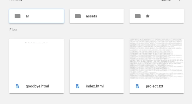

I've extracted in my Google Drive
and when I click on the index.html - this is what comes up
It does not open up as an html as it does on my desktop. Instead - I just get this.
Any suggestions on this would be very helpful. I just want to get it set up so I can get feedback on it so I can finish this project and this class.

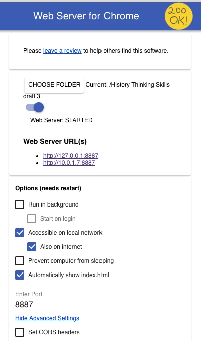

Ok, I used a Chrome Extension Web Server to get an address
and it gave me http://127.0.0.1:8887/ which works on my desktop, but not anywhere else.
I am at a loss as to what to do. This is proving to be much more difficult than I had thought.

Hi Mike,
While the other solutions as suggested by Paul, Lilybiri and yg236 are great! I would like to address your original concern; can you please let me know if:
1. Your audience\ reviewers will be using same network as yours to access your files
2. Have you tried a local server already?
Also, "http://127.0.0.1/8887" as stated in an earlier comment is your localhost i.e. your machine itself, hence no one else can access that unless you have built a local server out of it.
Hence,
1. If your users are using same networks as yours, install WAMP Server (a free simple to use local server) and share the link to your computer e.g. http://<your-ip-address>/location of your project on the c:/wamp/www/<any-folder>.
2. Alternatively, users\reviewers can download the entire folder locally and then run index.html out of it.
PS: For quick use, yg236​ 's solution is handy. Just make sure to 'enable' eLearning Output i.e. Course should be SCORM Compliant and should be published as zip.
/best
