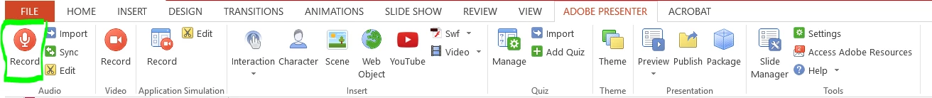

Still not clear on what you are using to record, but here is how to do it in Presenter.
In the Presenter ribbon in PPT select the Record Audio button:

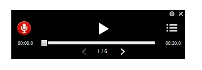

PPT will go to a slide show view and you'll get a dialog box to record your audio.

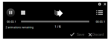

This dialog box has the option to record audio (red mic button), play back the slide audio (white play button), and the Script button (white button with three dots with lines next to it on the right). Once you start recording audio the Cue Animation button will appear in place of the play button and be white if there are any on click animations on the slide.
This allows you to cue your animations while you record your audio. Once you click the stop button you can play back your recorded audio and animations as well as click the Save or Discard button at the bottom right of the dialog.
